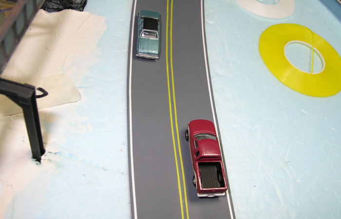

Speaking of chart tape, I use it for road markings in N-scale.
These both use 1/32" chart tape.
- Jeff

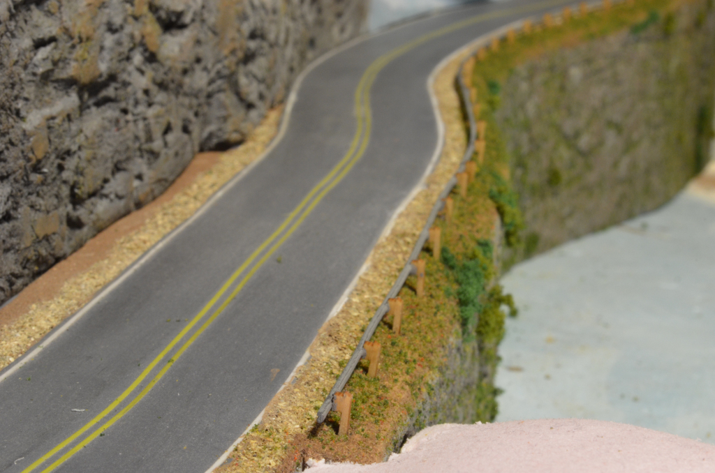

Your road, cliff, ground-cover, and guardrail all look excellent! After weathering, it doesn't look like tape at all! I thought that 1/32" would be closest to prototype in N-scale. I like that you also included the white striping as the outer road markers--very proto. Could you talk a bit about how you made the road itself?
The roadway is made from styrene and painted with rattle can gray primer. Weathering is done with weathering powders.
My source of styrene for roads is the inexpensive plastic "For Sale" signs available at discount stores and home centers. The backs of these signs are white. This type of styrene is relatively soft and pliable. It can easily be cut with scissors. So I drew the roads with a pencil, then cut them out with scissors.
The 1/32" chart tape is 5 inches wide in N-scale, which is just about right for the road markings. The chart tape can be easily re-positioned until you get it just right. After painting the roadway and positioning the tape, I applied a coat of clear flat spray, which helps to keep the tape in place.
The guard rails are from
Osborn Model Kits.
- Jeff

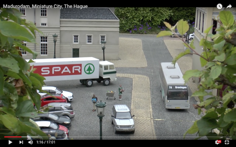

Here's another nice street-modeling effort found on YouTube with an operating Faller bus (scale unknown):

I still have some work to do on the left where the shoulder of the roadway meets the rock face. The brown area needs ground cover and weeds.
- Jeff

I still have some work to do on the left where the shoulder of the roadway meets the rock face . . .
Well, it still looks great! In fact, it's one of my favorite bits of modeling on the whole site. It looks so much like a coastline road scene you'd see here in California. The Osborn guardrails really make the scene, too--they're very true to prototype and look exactly like the guardrails seen along California mountain and coastal roadways. I would love to have a similar scene at the front of my layout, with the Pacific Ocean lapping against it. I've seen plenty of lake-front layouts, but I don't think I've ever seen an ocean coastline faithfully modeled.
