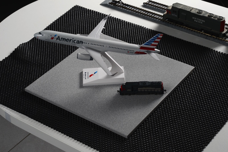

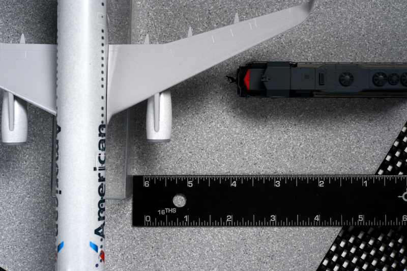

Thanks for all the helpful tips! What exactly does the clear spray do? Give it a matte sheen and sort of "protect" it? By the way, I think I may have found an easy way to make an airport runway! Our floor in the house uses a granite tile that looks lot like scaled-down concrete (see below). I think I have enough 12" x 12" tiles left to make a 10' runway. Other substrates I thought of include:
• Sintra® brand, closed-cell PVC sheets. Comes in light gray and dark gray, and is available in large sheets (e.g., 48" x 96" and larger).
• Wilsonart and Formica-brand laminates. These come in a huge array of patterns but is hard as hell to cut.
The other thing I was thinking of doing was laying down large, single sheets of gray Sintra as an "underlayment." Meaning, I can lay the Sintra on top of my work-surface so that the entire layout is concrete-ish looking from the get-go. It's flexible and easily drilled. I can also treat the Sintra with various materials, paints, and whatnot. I also want to lay large swaths of fresh-mowed, bright green grass (where commercial properties would likely have such well-irrigated lawns).

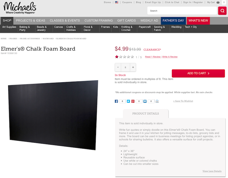

Well, even though I thought everything I ordered at Graphic Tape & Label was in-stock, my order still shows as, "awaiting fulfillment" on their site. Meanwhile, I was at Home Depot yesterday, and saw this Rust-Oleum chalkboard paint, which may be a good candidate for painting asphalt road surfaces (onto which I would apply the graphics tape for road markings). There's a tiny bit of silvery glitter on the can's color-keyed cap (which would improve its asphalt-ey appearance), but I'm not sure if it's actually in the paint or not:

I'm using the Foamcore as-is. I got the Elmer's Chalk Foam Board at Michael's today (you have to show them the sale price on your phone), and it's virtually identical to Foamcore-brand foam board bought at an expendables supply store like Filmtools (which sells Foamcore in 4' x 8' sheets for the film/TV industry). The Elmer's board's thickness is exactly the same height as the Unitram pieces, so it should fit into my layout quite nicely. And, unlike wet/dry sandpaper, it should more readily accept the graphics tape adhesive (if, and when, I ever get my order filled!). Its matte-black surface (one side only), should make a reasonably realistic-looking asphalt surface once the appropriate graphics tape is applied.
