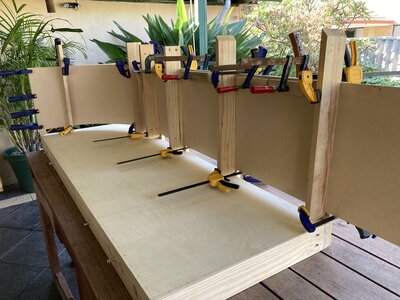

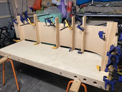

Been working on the backdrop side of things, was hoping to have it finished for the weekend but the nail gun packed itself in.
These are the sides, just have to the middle and I can start on the XPS foam base. The backboard is 3mm MDF, it's 400mm high plus I raised it another 25mm of the base since the XPS foam is 50mm thick. The corners have a 400mm radius, I wanted 300mm but it just felt too tight.
I try to get a tighter radius by kerfing the MDF and it looked promising until that finally little bit before the MDF shat itself.

I would suggest putting tape on the floor signalling when to stand up, handy with a duck under. What will you be doing on the backdrop? I know what you mean with the bending the mdf ( we call it hardboard over in Canada) , I used it on my fascia.
Good idea on the tape, not looking forward to the day I can't duck under any more.
As for the back drop, the sky colour I have Ozone Blue, which I'll transition from white at the horizon. As for the landscape I have a few pictures that I was going to use, but I thought I may wait until I have some track down just to see how it feels.

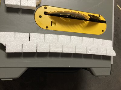

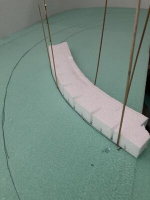

I'm having a go at making my own inclines and risers with batters using XPS foam. I first thought to try it out using polystyrene foam.
So to make it easier to line up the centrelines on the layout, I'm doing them in two halves. So for the test the riser will be 30mm high and 80mm wide so I can fit the 1 in 1.5 batter.
The weapon of choice was a table saw. As I was going around a radius I kerfed the piece at 50mm centres, I cut in 35mm towards the centre, with a 3mm blade and staggered the cuts on both sides. I was able to match in all the radii I have except the 600mm radius which broke, but with some care I managed to get it but it did feel tight (the pic is on the 600mm radii) so may have to go to 40mm centres.
As for the cutting the batters on the table saw, first time I experienced kick-back, didn't think foam would fly that quick. Anyway the batters didn't come very good, so I might just a jig-saw or cut the the batters first then cut the curves. Here are a few pics, so it makes a bit more sense.
