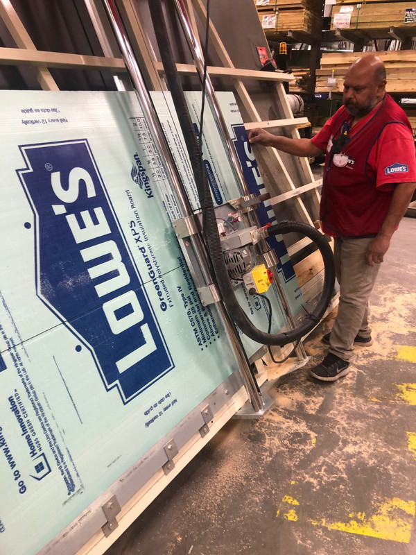

Nice pictures and great start to a layout that looks like it will be alot of fun. By the way... Keep on good terms with Yaz. When I bought my 4 X 8 piece of 3/4" green foam insulation at my local Lowes, I was told they could not cut it down so that I could fit into my Honda to get it home. So I bought a cheap drywall hand saw and cut it myself in the parking lot.
