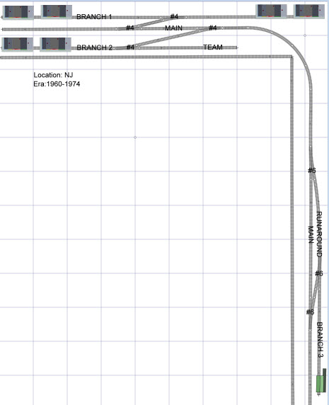

Back at it with a new 116"x20" HO shelf
Construction has been taken off "hold" (finally!)
After staring at the existing layout for a while I decided to add a section and reconfigure all the existing track and take the "less is more approach" by spacing things out with fewer turnouts/sidings. Just less track everywhere. I hope this makes operating more fun, and improves running reliability too
The new 10' x 10" wide shelf is to the right of the original section. It has a nice long "main line" straight with a siding that can hold 6 cars plus an engine. It also serves as the staging area.
I like the background buildings and by placing them I hope to create a busy feeling industrial area. If anyone has ever seen Sweet Home Chicago's train videos thats the vibe I am looking for.
SInce these buildings are on the other end of the industrial area they will require a reversing move of the locomotive at the long siding. I hope this will add some interesting operating moves.
Team track here for unloading tractors and heavy equipment
to add more operating interest on the "far end" of the layout these two are going here

So this is where things stand at this time.
At this stage now is the time for any and all feedback before track gets glued down, wired and painted!

This is a layout after my own heart! I love shelf switching layouts and this is one of the best I have seen. My own switching layout (see the thread for it) is set in NJ/PA area so your M&E Alco would be just perfect for my layout - I love the sound of Alcos :)
kleiner: your layout build inspired me to start mine back up!
I am glad that I was able to get you restarted. The lighting from the LED strip looks spectacular now - much better than the ceiling mounted lights. On my own layout, I recently realized that lighting is not as good as I want on some parts of the layout so I may also need to install some kind of an LED strip myself.
