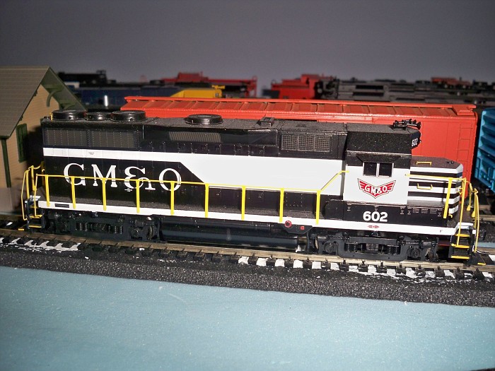

I don't have the Conrails, but I do have two GM&O ones they had a couple of years ago. According to the folks at the GM&OHS, some of the paint is not right here and there, but I'm not too concerned right now, since I've still got to complete the tracklaying so I can enjoy my layout some.
I plan to put sound in them one day. They run well.
