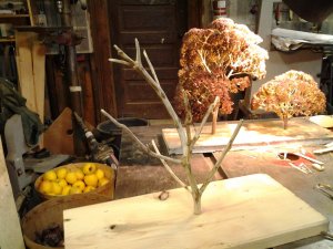

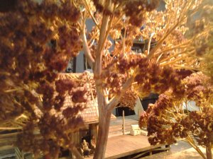

I use dried sedum from the flower bed in front of my place. Dip it or spray it in whatever adhesive is handy and shake WS ground foam on it.

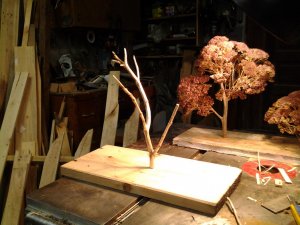

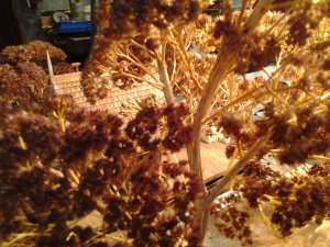

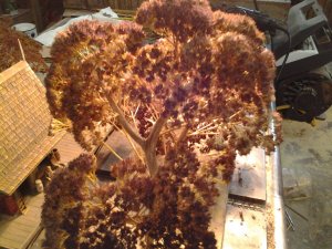

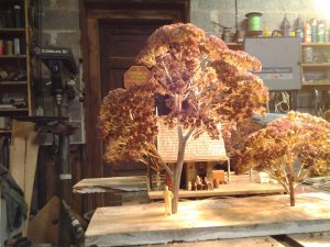

Here are some pictures of a tree I made with an old dried out weed and some sedum from the garden.
Not really done yet, have to be painted etc...

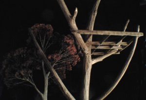

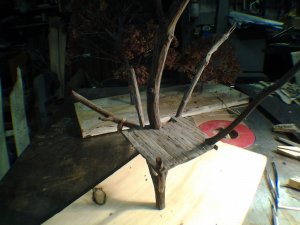

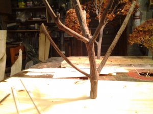

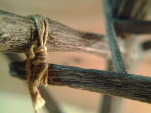

Forgot to mention in my last post, I am modeling in On30.

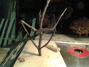

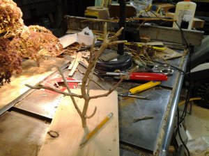

Starting another one today that I want to build a tree house in.
It is just a branch pruned from a tree. I remove the bark with a knife.
I drilled some holes and added more branches where needed.

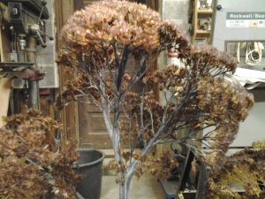

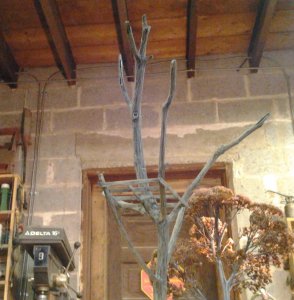

We in cetral Alabama are actually lucky in regards to using natural materials for trees. We have a plant here, called Wild Oak Leaf Hydrangea. Its a perennial, that in the autumn its flowers turn brown, and it releases seeds for its pods that are close to the blooms. When I say it grows wild, it really is all over the place.
They are real easy to process, you get a pair of scissors, cut off the blooms, and you're left with a very nice armature. These can be dipped in glue, and ground foam applied, or the colored "netting", (vines?), from WS can be stretched out over the tree and glue sprayed on to it with ground foam then shaken on to it.
There are many other ways to handle the "frames", as there are ways to come up with new trees. These can vary in length from 6-12" in height.
Trees painted, no leves yet though...still thinking about that.

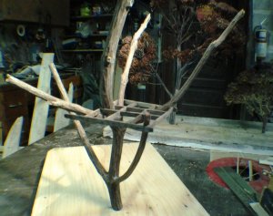

Started the tree house.

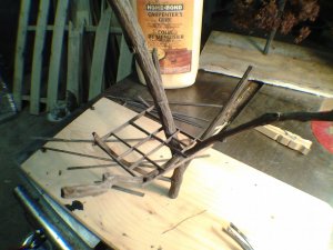

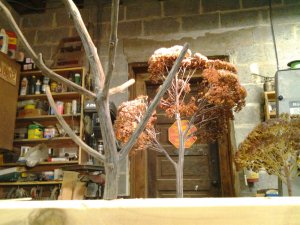

A little more done...
