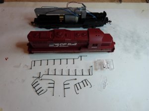

I decided to start with a Walthers Trainline GP9M, as this is going to be a static display,and it would be a cheap starting point. While the short hood is a little too wide, and the cab is not quite right, I figured with a few modifications and some detail parts it should look ok.

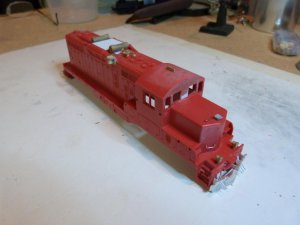

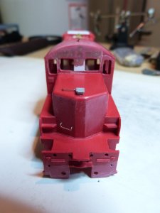

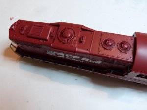

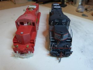

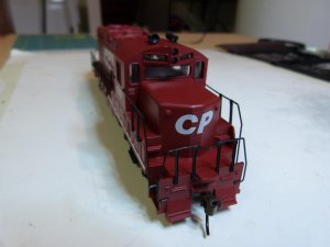

Here are a couple of out of the box pics:

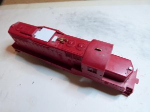

The first thing I did was to remove the shell from the chassis, then remove the headlight from the shell ( a piece of scotch tape held it in place!).
Next I removed the handrails, glass and roof mounted horns.

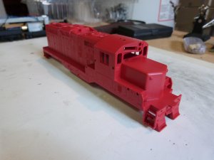

After that I stripped the paint from the shell, which happened to be molded out of red plastic.
Body modifications involved removing the front & rear pilots, front hood lights,front number board & headlights, exhaust stacks, center fan, rear handwheel & lights, and all molded grab bars. I also added styrene filler strips where the center fan was and also to divide the single windshield into two. As well, I filled the old horn mounting holes in the cab roof.

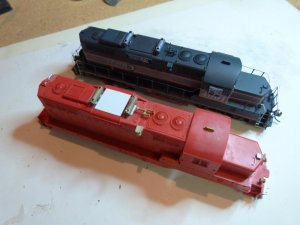

A few pics next to unit 4001:

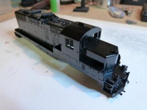

Here it is after primer and a few coats of gloss black paint.

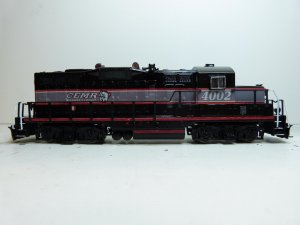

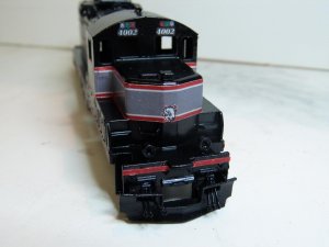

Got the decals printed and applied. Next task is to paint and apply the rest of the grab irons and other detail parts.
Finished assembly today. Nothing tests the patience like trying to insert a windshield wiper into a #78 hole.

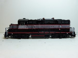

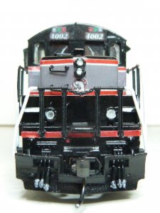

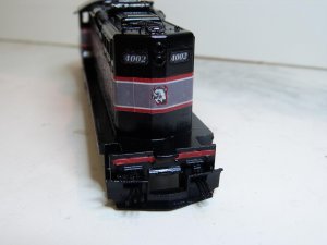

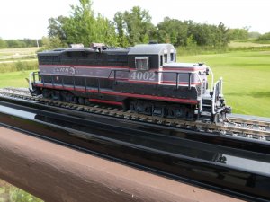

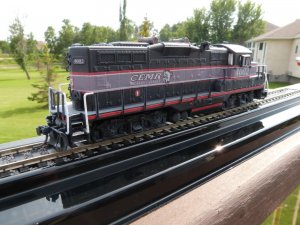

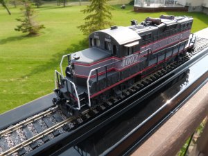

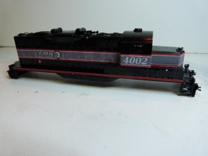

Finished up the GP9RM yesterday with a coat of dullcoat. It is sitting on the base of the Parma display case that I added ballast too. The customer is supposed to pick it up this weekend. I hope he likes it!
