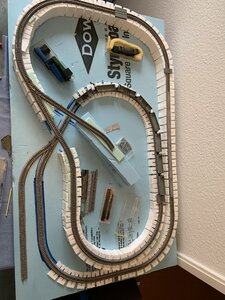

The layout is not very big, only 102 CM by 62 CM..40 X 24.5 inches tunnels in the back, quarry in the center.....

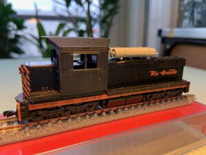

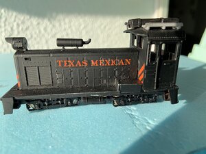

The engines are N Scale engines Converted to HOn30....here is one of them...not quite finished...and an other one...
