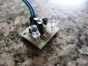

yes, the ones i was thinking of are from ebay, run about a dollar, and use a resistor / capacitor array, they flash approximately once per second, and alternatingly flash two leds [they can flash four leds] .. and run on around nine to twelve volts, search for 'cheap flasher kit'
