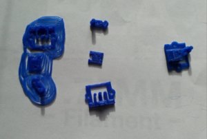

OK, I've got some of my first prints finished. Most of them are upgrades to the printer itself, but I did do a couple ground throws for my turnouts. On the left is as it came out of the machine, with a brim. Earlier ones didn't need it to stick. The middle column is the component parts and the last part is the assembled unit. The hole is 1/32" wide, and I will be attaching it to the actual switch via some piano wire running through a styrene tube. The color is probably not ideal, but I'm probably going to make this temporary until I can afford some tortoise switches to do the job automatically.
Just forgot, this was from thingiverse.com . Worked fairly well with the initial settings.
