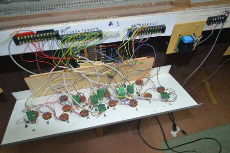

I use cable clips on my layout, still a rats nest though!
I use cable clips on my layout, still a rats nest though!View attachment 168301
Mine's the same, the only way that I can see is to have an aux power line down the Centerline of the board and use choc blocks to connect your ancillary equipment.
What I would suggest is that where you have two cables twist them together so they look like a single cable, I've started doing that now by connecting one end and then using a cordless drill to twist the wires together.
I used to twist wires together but had a very unfortunate incident at an exhibition where quite a large section of wiring was ripped out by the cables being caught on something, so now I keep the wires separate so the damage would be much less if it was snagged. I will be replacing the screw terminals with clip fit connections before this goes on the exhibition circuit in November.
I do need to tidy it up a bit though!
