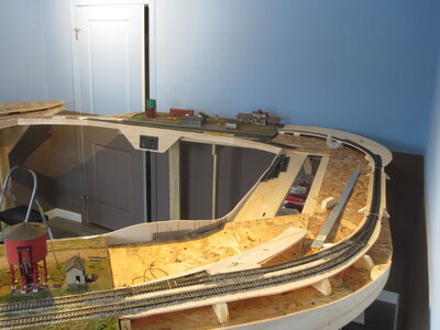

Not trying to disuade you from the foam usage, however I have always felt that plywood (or in this case 3/8" luann) gives you something more "substantial" to attach your track too, also I think automatically does good inclines:
This is all scrap lumber from other projects:
Before, this is my benchwork (HO) This is kind of messy work but knowing that the mess will be covered up with ground cover, etc.

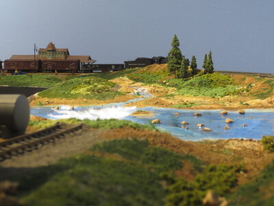

here is after, shows "south" far end after some landscaping:
note: green depot has been stationary, landscape terrain base made from window screen material and hydrocal.
