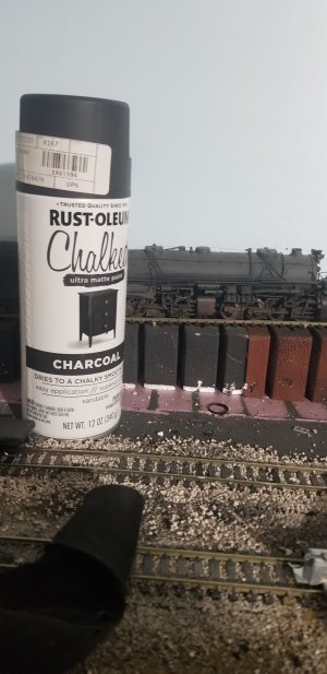

here it is
I would agree with that. Funny though, I didn’t realize it was a factory fade. I faded it my way on the top of the factoryView attachment 186117View attachment 186116

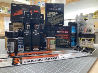

i have a question for all the weathering pros. iam following FOS Youtube channel, and some others. when it comes to weathering there is a technique or something what i dont know.
if a wash gets applyed to the surface, sometimes they are using something to "earease" some parts of the wash? Its i guess a liquid, but what liquid?
I hope you know what i mean and hopefully can help :)
cheers

If the medium being used is oils they most likely are using a mineral spirit type liquid to remove it. They are many types of mineral spirits available to the artist and painter community.
It’s a wipe on, wipe off type of activity. While they truly are not wiping off 100% of the medium they are leaving a slight film or coverage. Do it again to build up layers

If you are using oils like Tom mentioned , you can use mineral spirits to remove some of the wash to get certain effects.
If you do an acrylic paint wash and let that dry between coats... you can use Isopropyl alcohol to remove paints to get certain effects also.
You have to be cautious with the alcohol and take your time, start with a small area and work that till you get the hang of it. It will pretty well remove all that you added.
It is available in different strengths like 50%, 70% and 99% and is pretty well available anywhere.
Weathering things by adding and then removing stuff is just as effective as just adding.
Hope this helps you out man.

i never heard about "Abteilung502" but found it funny because of the german word. And i think FOS Scale Models talked about them in a video, so i just ordered some to try out :) everything in weathering is totally new to me. till now i only did some airbrushing for some models or buildings. so lets see where the ride will take me :)
