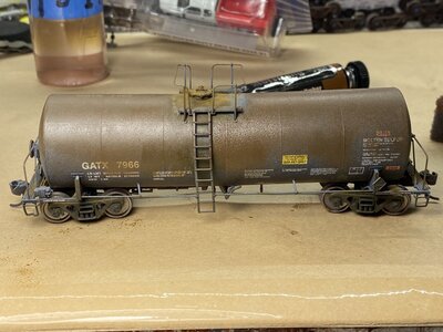

I am working on these 4 Scaletrains Rivet Counter cars as a weathering commission
The bodies were faded with a mix of Tamiya #x-2 White, #x-21 flat base and 99% Isopropyl Alcohol. 40% white / 60% ISA and just 2 drops of x-21 base. Each tank car got a different % of X-2 to vary the fades
24 hours later they were clear coated again with PMS matt clear vanish
The underbodies were sprayed with a 30% to 70% of Tamiya #xf-9 Hull Red and 99%IPA
Then Vallejo Air # 71.029 Dark Earth was brushed on for the kick up spray from the wheels
The wheels and truck frames were done per a client request with Vallejo #302 Dark Rust from the Panzer Aces series of acrylic paints. This matches the previous tank cars I have weathered for him. The axles and inside wheel faces were also done. The wheel face outer edge will be cleaned off tomorrow to indicate these ares have gone through a hump yard and the retarders cleanEd the outer edge of the wheel. They have to be thoroughly dried
any questions, constructive criticisms please type in

I will be stripping the GATX car, it was too overboard for my tastes.
