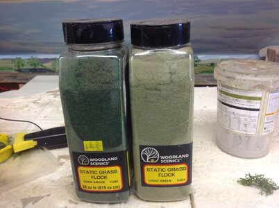

Static grass comes in many Forms, mixing and matching adds extra textures and colours and overlays

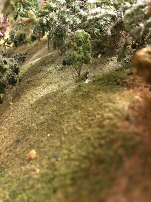

The garden is a great source of plant life that works at h0 and 00 scale
a dying tree provided a home to this small lichen
I dried it, I did not even bother dipping in in glycerin as is often advised,and it is going strong

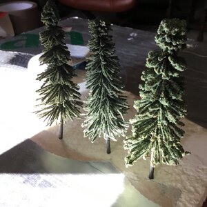

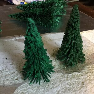

you can even weather your trees.
paint the inners black for shadows, then add wood chip painted turf for a nice finish on cheap bought trees, I find cheap hairspray is fine
