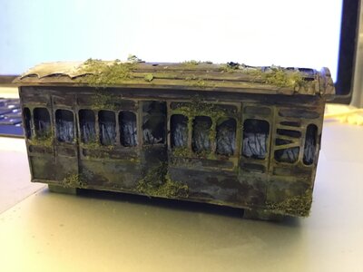

a. Fading wood,usually loses a paint cover first, but paint or not starts off as some shade brown and then turns gray, or grays, I personally find that a Matt black acrylic mixed with a white can end up with a wonderful variety of grays, no this shed shows the idea as I do not have an appropriate wagon to hand
Before
after
the wood texture on the shed is a total bonus
