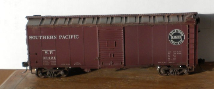

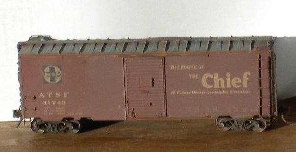

Would it easier to have a couple of sample cars with different degree of weathering so you both have an understanding of the potential outcome of the project.
These 2 are perfect examples of what Tom's "Medium" and "Light" weathering are to me.
Thanks for showing those David.
