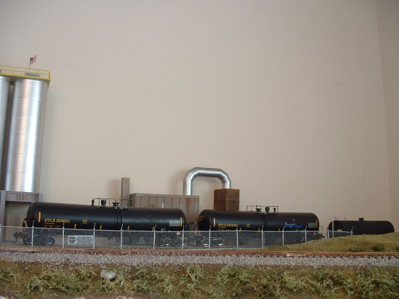

I managed to get it done and in. Not perfect, but it works I think! I ended up building it seperately, flat on a table with thick CA. Then, gingerly transfered it over to the layout and set it in.
Here's a couple pics of it. I managed to print out a few prototype signs and spray adhesive those up too.

Darn Kyle, that looks very very good to me. Like the pole tops for the barbwire.

That looks really good. Too bad it was so much agrevation. Using a sign to break up the run was a cool idea.
Kyle,
That's a great looking industry you have there! I don't recognize what kind it is, but I'm guessing some type of chemical? Anywho, the piping is my favorite part, especially the inverted "U" pipe between the two innermost structures. Looks like you angle-cut several straight segments, just as the prototype does it. (Plastruct tube elbows have no kinks at all, which is non-prototypical)

It's actually an asphalt plant from Walthers - seems like most of the aggregates get shipped in by truck (stored in silos) and the tank cars bring in the petroleum bitumens to mix. Kind of hard to represent everything there is to it, it's a sort of low-relief industry there. I stayed as close as I reasonably could to the prototype, which is ARTC, located in Douglasville, GA here. You can almost make out there sign I put on the side! :)

Id say that looks pretty sweet Kyle :D :D
Now you need to tone those asphalt silos down, there WAY to shinny lol :D
BTW, where did you get the flag on the top of the silos? Thats really cool
