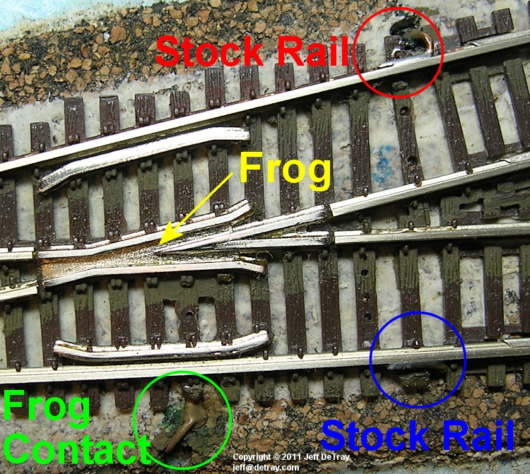

Atlas Code 55 turnouts do not require anything special in the way of wiring. The turnouts have built-in jumper wires (hidden under the ties) that provide power to all parts of the turnout except the frog. So in many cases, you need only provide power to the two outside rails, just like any other piece of track.
The frog might need to be powered if you use short wheelbase locomotives that may stall on an unpowered frog. There is a small round copper solder lug opposite the frog on one edge of the turnout that can be used to provide power to the frog. If you power the frog, you'll need to be sure the polarity of the frog is changed by whatever mechanism you utilize to throw the turnout.
The image below shows how I connect wiring to my Code 55 turnouts.

I have about 50 Atlas C55 turnouts on my layout. As you may be aware, they have jumpers built in to connect each stock rail to the corresponding closure rail and rail that exits the frog.
When I first started using them I just installed them just as they came straight from the box. However, I subsequently discovered that on several turnouts one or more of the inbuilt jumpers had failed, leaving sections of the track unpowered.
Now, when I install these turnouts, I solder track feeders under the turnout so that the wire connects both the stock rail and the closure rail, before dropping down through a hole in the sub-roadbed. I also check the inbuilt jumpers that connect the exit rails to the stock rails, and if they don't work I solder a new jumper.
There are photos here and here which I hope will show what I mean.
I use manual push-rods to operate my turnouts, and install a slide switch to power the frog. Photos are here.
