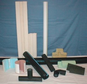

I'm a complete novice at this but have you considered black foam pipe insulation? image.jpg
I found a place in PA that has it up to 22" id. I'm sure you could find it locally. Could cut it in half and slice the sides for curves then glue the cuts.
I've never tried it but seems feasible.
