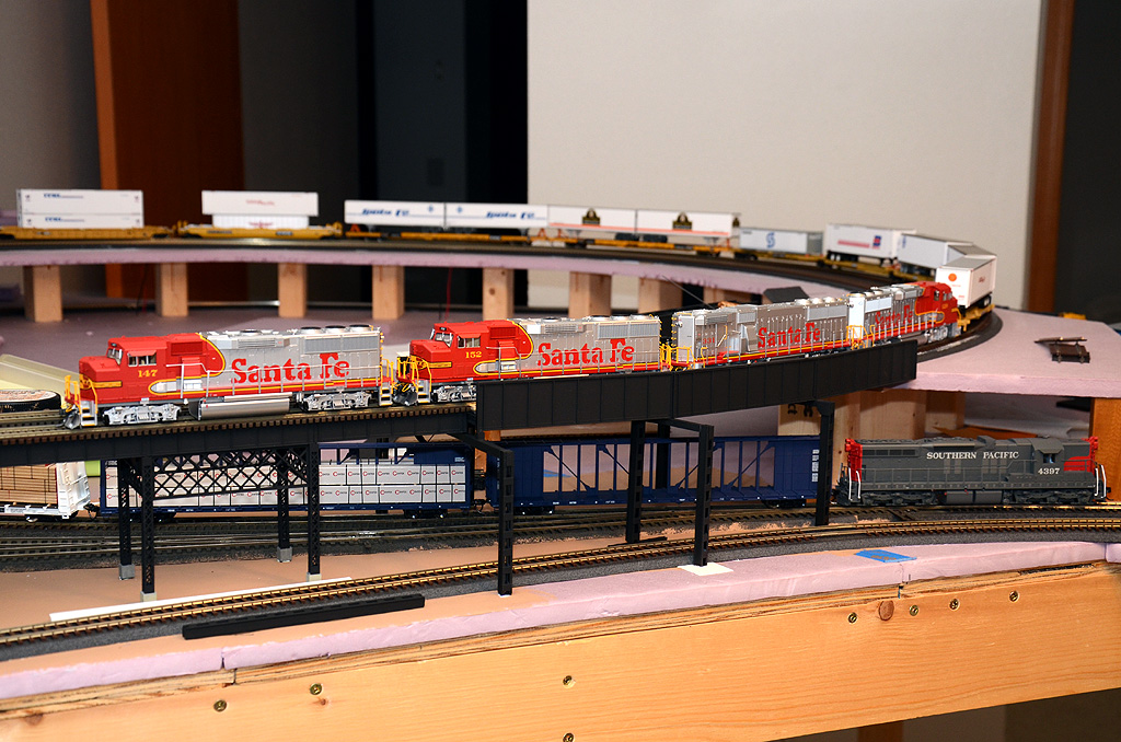

On larger layouts, the general practice is to have a track "bus" power line running beneath the layout. That's two wires carrying the current from your power source; every 3-6+ feet, you then have a small set of feeder wires going up from the track bus, through the plywood to connect with the track. Here's a picture of part of my layout (sorry it's the only one I could quickly find with an example of feeder wires). If you look carefully in the background underneath the trailers, you can see two sets of red and black wires coming up through the layout. Those are feeder wires connecting the track bus underneath to the upper level track, where they are soldered on.
