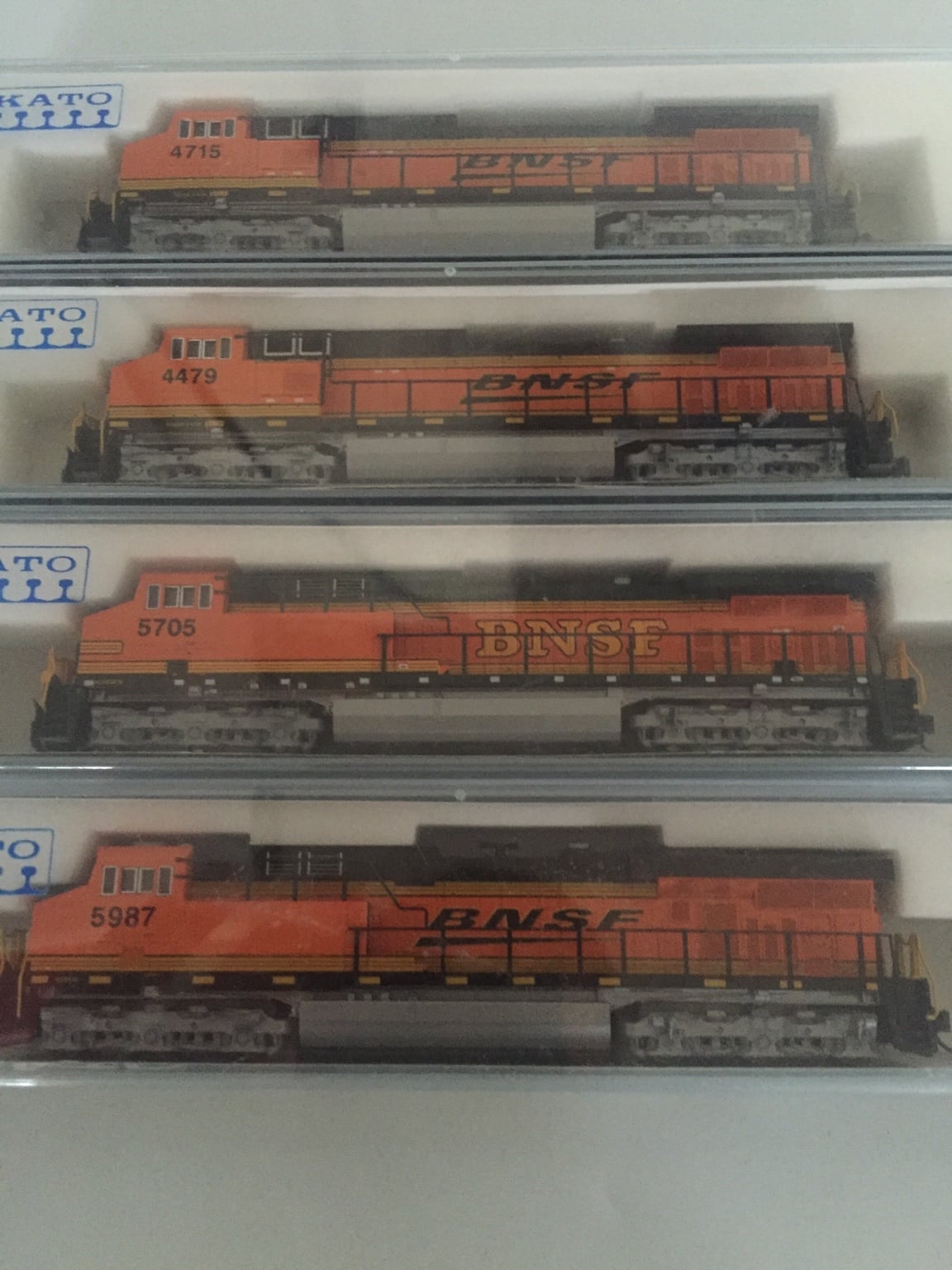

I love going to the train shows, went to the one in Pomona Ca today..... Got a few nice additions for the layout!
Sent from my iPhone using Tapatalk
