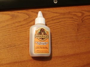

The gorilla that I buy dries clear. They make several different kinds. As far as the beer goes, never too early.

Here's the stuff I have. It dries something like an opaque light yellow.

The one I get, the bottle is similar, but it says on it "dries clear". The cap is blue and is longer and comes to a point.

That's the expanding foam type. It works best if you moisten whatever you put it on.
OH yeah! You right! I forgot all about that. Seems to be ok for what I'm doing with it right now.

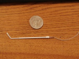

I got my yard lamp posts today. What sort of base would you, or anyone, suggest?
. No instructions of course. No matter. If there was, they would be written in some Chinese dialect.
For a base I drilled a hole (in my plywood) so the bottom part fit through but the wide part of the collar did not, put a drop of glue in there, and stuck the base in.
I don't know about the resistor. The ones I got from China must not have been LED because worked regardless of polarity and I did not use a resistor and they work. Mine didn't have instructions either.
I haven't put power to them yet so I don't really know for sure what they are. I'll put one on 0 volts and crank it up to see. If it lights, I'll switch polarity and see what happens. If it lights both ways, it isn't LED. Of course a simple ohmmeter test should ferret that right out.

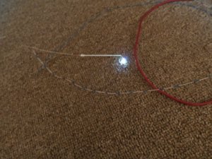

Here is one of them. It's not easy soldering to a single strand of "angel hair". White is ground and black goes to positive. A little backwards for me but there we are. Without one of the resistors it didn't want much voltage at all before appearing to stress out. Maybe 3 v. With a resistor in line at the same voltage with the rest, it's ok. That's around 9v. The resistor is 620 ohm.
Here is one all wired up and lit.
They'll work just fine. I am going to make some sort of base for them. I don't like the idea of gluing right to the table top.
If there is some sort of sticky goo that acts like glue that isn't permanent, I'm all game.

BigE- I have similar lights from China. What I did was drill the hole through the train board then put just a small dab of bathroom caulk (clear) in the hole and set the light in the caulk. If you spray ISO on the caulk you can remove it. I use the caulk in tubes that don't use the gun. On my signals I cut a thin piece of styrene (for sale sign) in a square shape and cut a groove in one side that the wiring (4 wires) can be slid into then put the dab of caulk to hold the signal upright. Hope this helps.

ISO? Probably something I'm already very well aware of... but what is that?
Tube caulk.. nice idead.. yes that helps.
I think I get what you are saying about a little square of styrene. Got a pic?
I'm pretty sure I got the idea and yes that helps as well.

Eric - if the friend Carey is planning to bring is who I think he is, you'll be in good company! BTW: ISO=Isopropyl Alcohol, in 70% or 91% concentrations. Perfect for softening dried Elmers.

I don't have a before scenery picture, but I drew it out for you.
After the light or signal is glued down and light is tested OK, I put another small piece of styrene over the open styrene wire slot, paint it and put ground cover over it and it disappears.

ISOpropyl alcohol - duh.. another one I should have known. I thought that might be what it was but had zero idea it would soften dried white glue. That'll be about the 4th thing I've learned today.

BigE,
Well done Curt. That's exactly what I thought you had in mind. Had I known those light posts would have come in today I probably could have gotten a "for sale" at the grocery store this morning.
I would like to finish off the ground work around my fueling station and put down ground cover over the yard area before I decide where to put these lights. Patience and forethought is something that seems to only come with age, experience and wisdom. 40 years ago this would not have been possible for me. That's ok. I'm producing a much better result these days.
