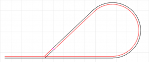

I have a narrow N scale shelf layout I am building. Due the narrow width I am using reversing loops. I hooked it up and the engine runs great until it comes back to the turnout, it just stops dead. I am still a newbie and can't figure out the problem. I am using Atlas code 80 and have insulated jointers on the return side of the turnout (where it stops). Any help would be greatly appreciated. I am very frustrated with this project!
Thanks,
Bill
I think you're having a polarity problem with your return loop (if I read your post correctly), assuming you're running DC (as opposed to DCC). Correctly wiring reverse loops has always intimidated me, so I've avoided using them on my previous layouts.
However, it certainly can be done, they just have to be wired correctly. I know reverse loop wiring has been covered in model railroad magazines and books, and I'm sure the information could be found online. Maybe try a Google search for model railroad reverse loop wiring.
If you can provide a diagram of your loop (even a pen-and-paper rough sketch will help) I think you'll find you get more specific/helpful info. Based on what you've said, all I could offer is "Yeah, your reverse loop is somehow messed up"... With a diagram, I could probably give you much more useful advice...
My pure 100% guess based on what you said is this: You said you have insulated joiners on the "return side of the turnout"... You would need insulated joiners on BOTH sides of the turnout. The reversing loop must be completely isolated. Then it must either have a toggle switch to change polarity OR an 'auto-reverse' mechanism. This is just my guess. And it depends on if you're using DC or DCC...
The drawing posted by fcwilt is not a functioning reversing leg. It would require insulated joiners at both the entry and exit points of that teardrop loop to function as a reverse loop, and, both the isolated loop AND the mainline need to be able to be reversed via a DPDT switch between them and the power controller..

I finally got some DPDT switches, wired it up like your diagram, Bingo!! Works great. I can't thank you enough! Thanks to everyone who helped me through my dilemma! Now maybe I can make some progress!
