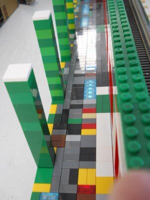

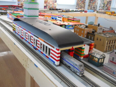

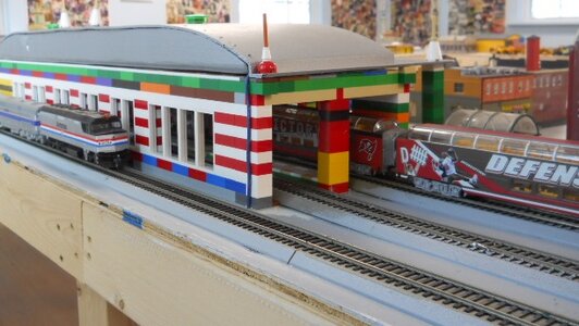

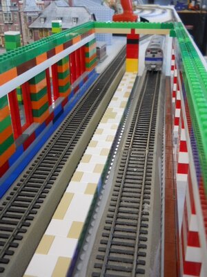

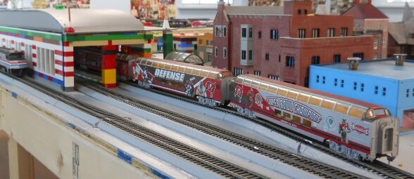

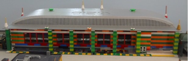

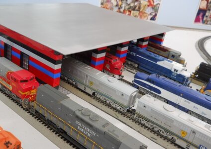

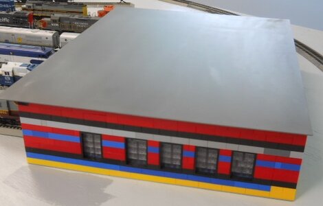

Hears a project that I just finished. A roof for the Lego's Train Station. I'll have to make about 4 entries(posts)to show you how it's made. I started out w/a back off of a 32" Vizio flat screen TV. I had to cut it down w/my Hot Knife to get it small enough to fit in my Bandsaw. Then I cut it down to the size I needed. 7-13-23 I used 1 of the reflective lens out of the TV to cover up the slots in the raised part of the roof. Icut it to fit, then I installed 2 sets of LEDs in the inside of the roof. I used the reflective side of that sheet instead of the see thru side.
I used a pc. of 1 by 4" shelf board cut to fit the back of the roof. Then I added some Lego parts to the roof to fill in the holes. Painted the inside & outside w/Krylon Fusion Hammered Silver rattle can. 2 coats on each side. The whole project took about 4 hrs to make. The roof is 31" long-9&1/2" wide & 2" high in the middle. The last picture is the inside of the 2 rail Station w/a platform down the middle made out of Lego Bricks & smooth side roof panels. 7-13-23

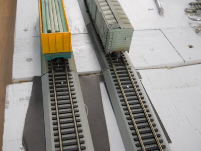

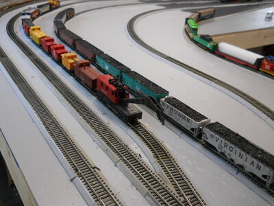

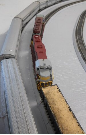

Finally got the Passenger Main Line running last week. Found a few track problems the 1st time it went around & fixed those right away. A few more days of under table wiring to get the Freight Main Line going & then will start on all the sidings wiring, etc. 7-26-23

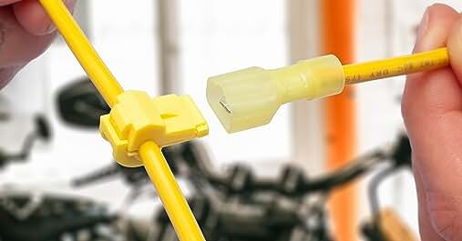

Just got the Freight mainline running yesterday after hooking up all the Drops to the Buss wires the day before. Has anyone tried "T" Connectors besides me under the layout? These are so nice to use when you can't see under the tables to do soldering. I bought all of mine from Amazon. I ran all of my Diesels(55)to make sure they ran ok & only the last 4 in the pictures were bad. 3 are real noisy which I will fix & 1 doesn't run at all which I will also fix. The right side in the 1st Picture is the passenger main line & the one on the left is the freight mainline. I hooked up 36 pass cars & used 2 engines to pull them. I could have done it w/one P42 but it was a slight hard pull, so I added another engine. Next is wiring up all the Sidings on both rails. I bought enough 1 by 12 shelf boards to make all the Facia on the inside of the layout which will be painted dark green flat latex. I also bought 2 pcs of 4 by 8ft by 2" thick Pink Insulation foam for making mountains & a pc. of 4 by 8ft by 1/4 in. Hardboard(masonite)to make table retainers on the outside of the layout to keep equipment from hitting the floor when it derails. Those pcs. will be 2in. high about the table top. I work almost 7 days a week most weeks & about 8hrs each day. Being retired since 2008 has it's perks. Going to be 85 in 2 months & everyone tells me I need to slow down, for what I don't know. 7-30-23.

This is what I use. I only use the Blue to tie into the Buss wire & the reds for the Drops. Whats so nice about these is the red male connector will plug into the blue connector real tight. All the different colors will plug into each other w/ease. I use the clamp on blue connector for the Buss which is 14 ga. & the red male plug for the solid 20 ga. drop. All you need is a wire crimper & a pair of Channel locks. I buy mine in Bulk. 7-30-23

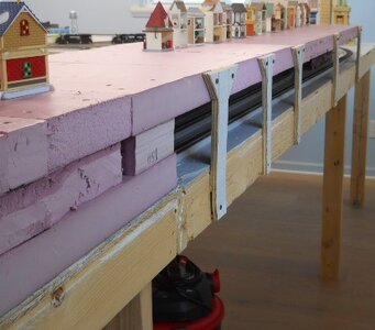

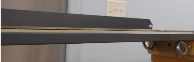

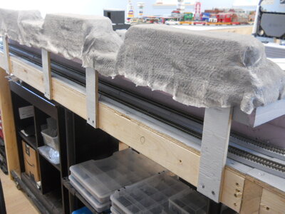

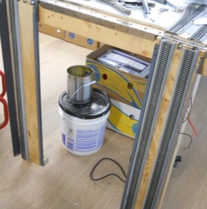

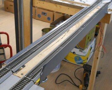

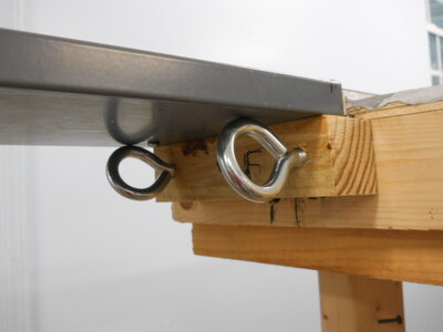

Finally gave up using wood as a Bridge in the pass thru opening in the layout. 1 day it would warp to the back & the next day it would warp the other way. next door neighbor was throwing away a set of metal shelves on a steel base w/slanted shelves. I looked for aluminum channel for about a month to make the 3 bridges & finally gave up. So, I decided yesterday I was going to figure out how to use some of that shelving for 2 Bridges. This thing is real strong & light weight & I sepperated the 2 bridges to open seperately so the piano hinge wouldn't warp. t works really good now. 8-6-23 later I'll add some frame work to the sides made out of wood to make it look like a real bridge. this took me 2 days to build. I still have more room on the back bridge to add more track if I need to. I've been running trains off & on almost everyday for about 3 weeks. Started wiring up the blocks in the yards & in front of the engine house this week & will add all the toggles to operate it all as soon as I get my facia boards up & painted.

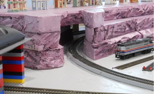

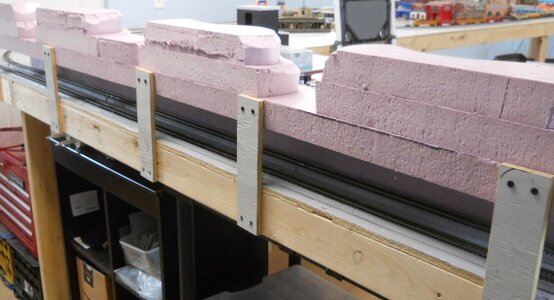

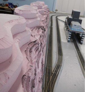

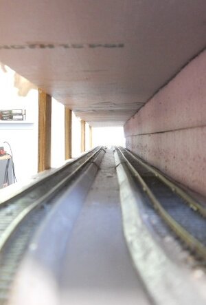

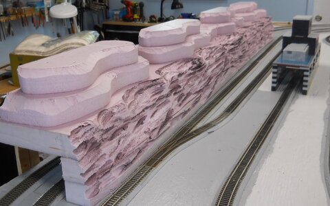

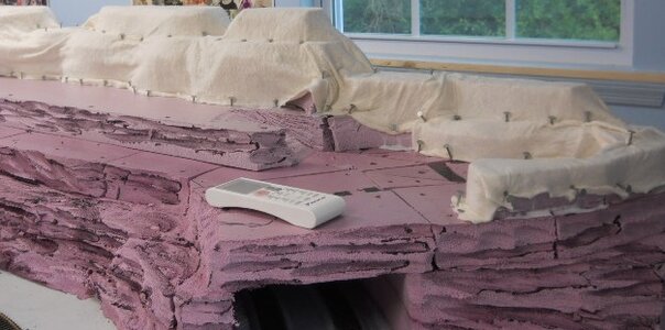

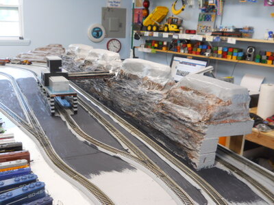

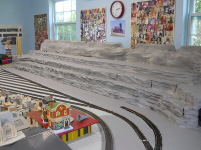

Started building a large Mountain w/a double track mainline tunnel. This is 2" Pink Insulation Foam that I bought at Home Depot. I bought 2pcs. of 4 by 8ft. One pc. for this mountain & 1 pc. for the other mountain on the other end of the layout. The one in these pictures is only about half finished. Still have to add some more to the top & finish cutting the front & the ends. 8-11-23
I still have to a lot of carving to the front & add a lot of rock faces & was planning to add roads to the top in different levels w/small buildings & then a road down to the front at one end & make a Overpass to the front of the layout. Lots to do yet. There's actually 3 different track openings in this mountain tunnel. 8-11-23

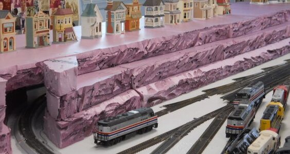

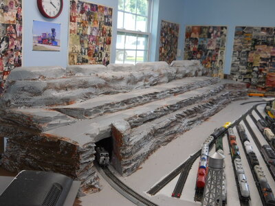

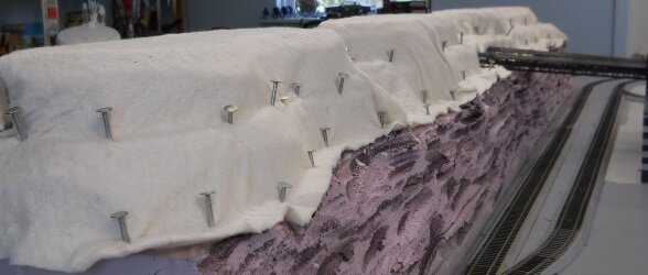

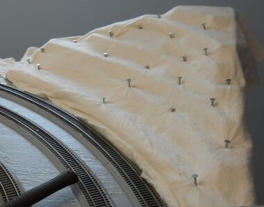

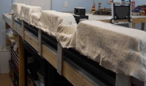

Started on the Tunnel & Mountain on the other end yesterday. Also a double mainline tunnel. This one is for the Coal Mines & loading building. After I cover it w/Quilt batting & paint the whole thing it won't even look like a foam structure. Still have to make tunnel portals for both mountains & will probably make those out of wood. I had a lot of foam board left over from yesterdays mountain to finish up the 1st one. 8-12-23 When I get done w/both mountains I will hang black felt over the opening in the back so you can't see the inside of the tunnel from either end or when you walk behind them.

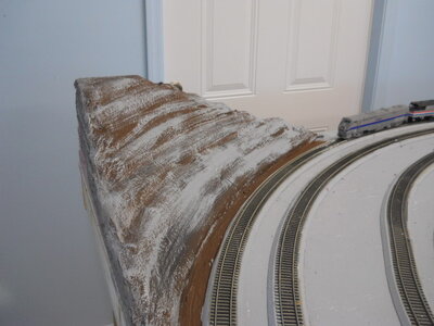

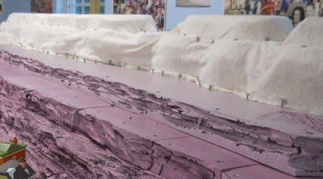

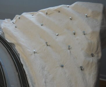

GOT THE Mountain/Tunnel Covered w/Quilt Batting on the other end of the layout on the 14th & hope to get both mountains painted tomorrow the 19th. After they get their 1st coat of Latex paint they will look completely different. Then after that dries they will get at least 3 more colors added on each mountain & then when that dries the Grass gets added on top of a liberal coating of Elmers glue. Then comes all the Tree's & Foliage. 8-16-23.

Painted both mountains today. Took about a half gallon of flat light gray Latex paint. This is the 1st coat. Took about 3 hrs. to do both. I'll let it dry for about 2 days & add another coat. I use the 2" throw away brushes from Harbor Freight. 8-17-23

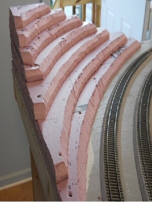

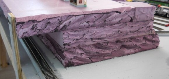

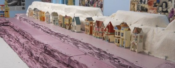

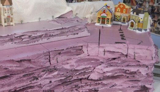

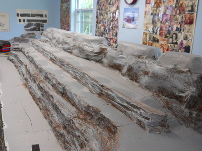

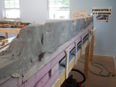

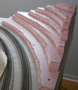

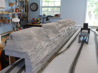

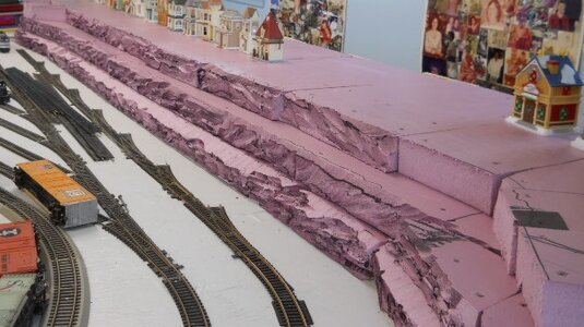

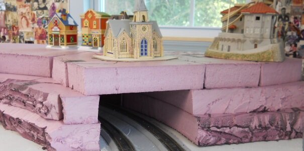

I made mountains on 3 of the 4 corners of my layout. Here's how I make them. Use 1" thick pink foam insulation board & cut each piece a little bit smaller as I go up from the bottom. 8-21-23. Then added some Elmers Glue on each level & covered them w/quilt batting & put on the 1st coat of dark gray latex flat paint. Tomorrow I'll add a 2nd coat of Latex.

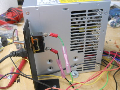

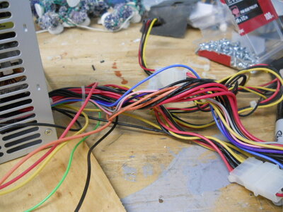

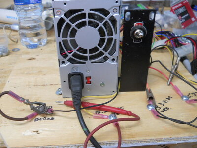

Finally took some time & made an Electrical Test Stand for checking LED's & stuff. Have 3.3 Volts for checking those battery operated LED's which is the orange wire & 5.7 Volts for checking other LED's & such, red wire & 12 to 13.3 Volts for those 12 volt LED's which is a yellow wire & a hookup for the ground which is black. Then I hooked up the power supply it's self w/the green wire for hot & a black wire for turning it off & on. there's other wires for negative hookups in the same voltage. there's a thing about hooking up an LED the wrong way & the PS will shut off instead of destroying your LED or whatever your checking. Been using these since about 1990. I always check out a bulb or an LED before I put it in an engine or a light post or a building. I use to sell these for $50.00 ea. All the xtra wires hanging out the back is where you hook up your lights by color of the wire. I use a lot of battery operated lights w/this system. Almost all Dollar Tree string lights, book reading lights take 2 double A or tripple A batteries which is 3 volts & the 1's that takes 3 batteries needs 5 volts. I try to hit Walmart right after Christmas & gather up a lot of Cheap LED's which are 3,5 or 12 volt DC. When I was recycling electronics from 2010 to 2017 I had about 300 Power Supplies that I got for free. When I moved up here to Georgia last year I had to leave about 50 PS's. About 3 weeks ago I started going around to business places looking for old Computers for free & got 3 from 1 spot. They all work & don't forget to make sure it has a fan in it so you will know when it quits if you hook up a light the wrong way. 8-26-23.

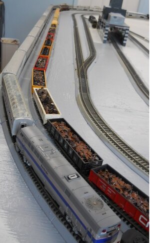

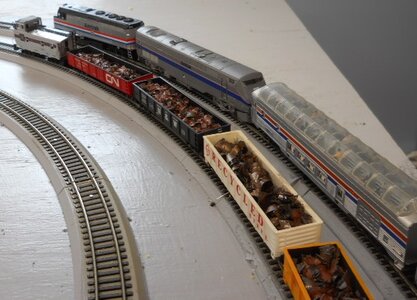

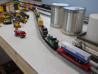

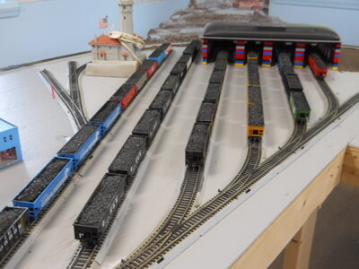

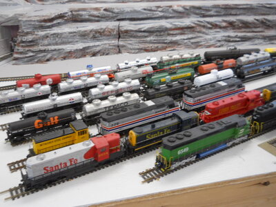

I had almost all my freight cars sitting in banana boxes on the floor under the train tables & the other day I had a few visitors w/kids & they wanted to play w/some expensive trains so yesterday I set all the Coal Cars on the tracks & a lot of others until I ran out of track space.
