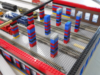

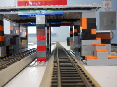

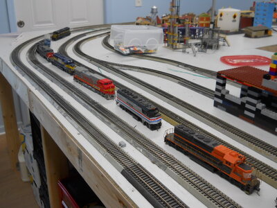

Engine shed made out of Lego's & I've still got to add another section to the left of this one. 6-16-23 To be able to add another section I have to take apart 1 of my big buildings to have enough Leo's to build an add on Shed. I might just use one of the 2 bay sheds I had on my other layout in Florida.

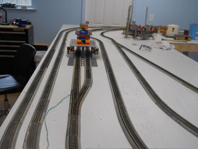

I added 6 more inches to the depth of this yesterday. It's now 15" deep & 20" wide & I also raised it up about 2". As soon as I can find some old junk flat screen TV's I'll put a clear roof on it.

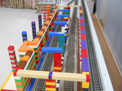

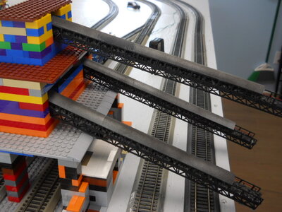

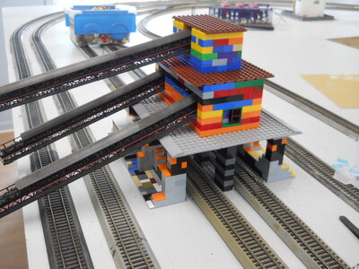

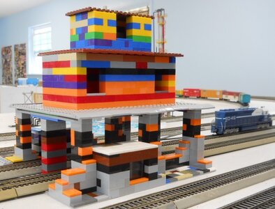

Built a Fancy Coal Loading Facility out of Lego's today. As soon as I can get some rattle cans of paint I'll paint it silver or Gray & then mess it up w/some flat black paint. I'm finally out of Lego's Bricks. Have a mess of small stuff that I use quite often on Non Legos. The Conveyors will go into the side of a mountain when I build it. On my last layout I made a giant Loader out of screens out of Computer Monitors. It had spaces for 12 cars & a depth of 18". This one is for 2 coal cars at a time. 10" wide, 10" long & 10" high. I had to cut the base plate in half length wise & the slide the 2 pcs. under the tracks & then finished it w/center posts holding the 2 pcs. together. 6-18-23

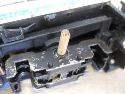

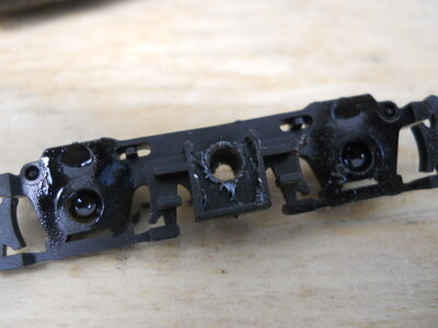

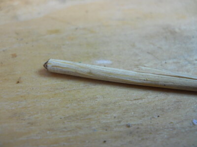

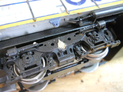

2 of my Truck Side rails came off because the pins in the middle of the frame was broke off. I had 1 of those sudden Brain Storms how to fix it. I have a mess of chop sticks that I buy at Dollar Tree(Wood Dowels w/a point on one end). I took out the broke plastic pins & then I cut down the dowel of the length I needed & then drilled out the Side frame a hair smaller than the diameter of the Dowel & cut it to the length I needed. Here's a few Pictures. I also glued the dowel in the plastic side frame w/E6000 glue. You might have to take a little off of the outside diameter of the dowel to get it hammered into the truck side rail. After the glue dries overnite in the plastic side frame you could just file down the end that is showing & paint it flat black or whatever your side frame color is. This was on a SW1500 Athearn Switcher.

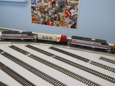

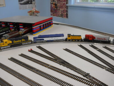

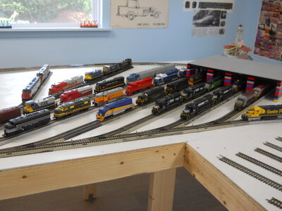

Some of my Engines sitting on the rails in front of my engine shed. 6-21-23 The 2nd & 3rd picture is a few of 16 Dummies I have & the 4th picture is the Engines I still have to repair that were water damaged in the hurricane in Florida during Hurricane IAN.

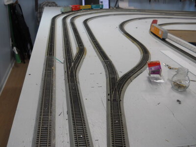

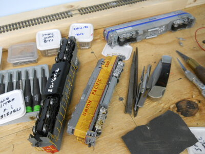

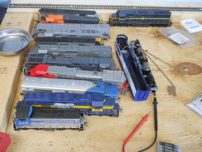

Finished repairing the last of my engines of the 32 that were damaged in hurricane IAN last year. Worked all day today & did the last 10. Have 3 that I had to add Pins to hold the side rails on the Trucks. Waiting for the glue to dry for a cpl. of days. All the Track has been nailed down & then comes the cleaning mode & soldering all the Drops on.

Changed the Coal Loading building to a single Track instead of dual tracks & rebuilt the building. I'll have to paint the top portion later. It lifts off easy. Still using Lego's. Still looking for broke down Flat screen TV's to make roofs out of the Screens in them. I was planning on using the Lego Roofs, but they don't look lake a roof. Here's the Engine Shed & The RR Station w/out a roof.

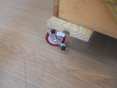

Started doing the Main Line Wiring under the layout today. 2 sets--one for passenger Main & one for Freight Main. then tomorrow will run the Phone line for the CM-20 transformer & then the wires for the LED lighting & then the wires for the 3 different sound systems. Lot harder laying under the tables this time since I'm over 80. Had to put larger wheels on my under table couch. 7-7-23 Built this back in 2007. If you make one for yourself it needs 4 casters. Bought my bigger wheels at Harbor Freight yesterday. $5.99 each.

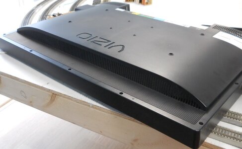

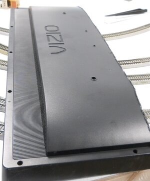

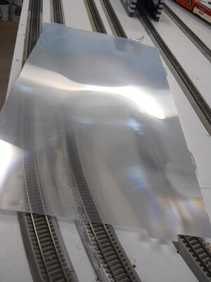

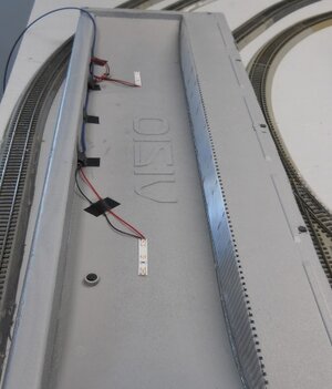

Hears a project that I just finished. A roof for the Lego's Train Station. I'll have to make about 4 entries(posts)to show you how it's made. I started out w/a back off of a 32" Vizio flat screen TV. I had to cut it down w/my Hot Knife to get it small enough to fit in my Bandsaw. Then I cut it down to the size I needed. 7-13-23 I used 1 of the reflective lens out of the TV to cover up the slots in the raised part of the roof. Icut it to fit, then I installed 2 sets of LEDs in the inside of the roof. I used the reflective side of that sheet instead of the see thru side.
