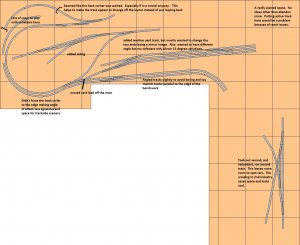

Here are some of the ideas that I had based on the latest main line design. Don't know if they will really fit into their spaces or not.
1. Changed the yard lead to the siding instead of the main.
2. Reduced the distance the loop on the lower left side goes toward the edge of the board.
3. Had an idea for the upper left corner dead space.
4. Re-did the main yard to make it less symmetrical. Added a 3rd track but that certainly isn't that meaningful.
5. added an industrial track to town in center left.
6. Suggest getting away from the very front tracks being parallel to the benchwork.
7. eliminated the 2nd double ended siding (passing track) in the town on the lower left. It is not necessary and mostly wastes space and a turnout.
8. added a 2nd industrial siding going the opposite direction using a crossing to get there.

Horseman,
Thanks mate and I like the things you have suggested. Now I need to see if I can work it all in.
Reach into the n/w and n/e corners is going to be a "stretch", around the 40" mark, but I knew that from the start. Having the tunnel in the n/w corner was only put there to "break up" the blandness of that area and for no real reason. What would you suggest for that area, knowing the reach situation, if I removed the tunnel?
that is always the trick isn't it.
I don't think I would remove the tunnel. In fact the tunnel lets you hide a notch or something in the bench work and scenery that you can use to as under layout hand access the track inside.
Horseman,
So far I have "re-aligned" the center yard and made the changes to the track work that you suggested. Certainly is more interesting and takes away the "square look". Have also added the siding to the western town/yard track work, and that works well also. Will be playing with the other changes later this afternoon/evening.
You make a good point about the tunnel allowing for beneath the layout access; as such, the tunnel stays.
