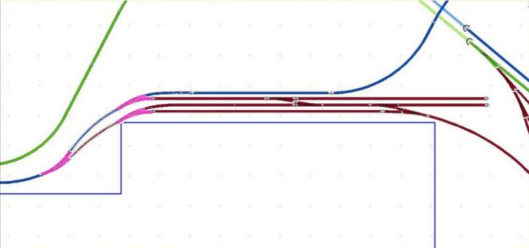

Here is what I was able to create in 90 minutes, with my crude graphic editing tool. I used the same radius curved turnouts as the one you already have, but in real-life you'll probably want to use broader ones.
I eliminated the two short stub tracks on the left [west] end and substituted curved turnouts that ease more gently into the yard. On the right [east] end, I swapped the bottom right-hand t/o for a left-hand one and slid the pair of them ~12" further to the right. In a nutshell, I was trying to eliminate the "staircase" pattern of zig-zagging crossovers going thru the yard while still providing access to the various tracks.
If only I'd had more time, I'd have bent both yard tracks downward and made it into a curved, double-ended yard (eliminating the need for that crossover in the middle). But hopefully you get the idea...
Ken thank you, and I tried getting what you suggested to work; however, there is a gradient issue. With the yard/s as they are the yard connecting track has a 3.1% grade that I can't lower. When I put in the 3 other tracks (as per your idea) I ended up with grades of 4.0% to almost 5.0%.
I'll keep playing with the idea and see if something can't be changed to accommodate your idea but at the moment that looks doubtful.
Looking at Ken's modification to the yard's left entry, I would suggest, in order to get that blue track up and over the double tracks, only connect it to the yard tracks by that leftmost turnout, moving that also as far to the left as possible, and start the grade from there.
Thanks and yeah, I did have issues with radius using all 3 of Ken's thoughts for the western entries into the yard area, not including the main line. As such, I am only going to be using 2 of those entries for the bottom most yard track. Here are the changes that have been made and that keep my radii around 17" with grades at (or below) 2.0% and still gives me clearance across the double tracks:
The only part of this I am not quite sure about is the curved turnout to the right of the yard on the main line, just before crossing the double track ... that is a little tight. The only reason that is it there is to allow west bound trains into the main yard. Without it only east bound trains can enter the yard and that doesn't seem realistic to me.
