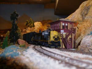

I think this is the last locomotive I have to show. This is a Bachmann RS-3 with DCC and sound. The loco came from ModelTrainStuff.com as an Erie RS-3. The Erie paint job is mostly black and so came fairly close to the Northern Pacific's paint scheme. I searched through photos of Northern Pacific's RS-3 and found that RS-3 861 had a fairly easy paint job to match. It only had the canoe end on the short hood end. The long hood end is simply black. So, the new paint was almost simply a matter of painting over the yellow parts. I changed the normal direction of travel, so forward runs with the short hood forward. The yellow used on the Erie model really did not match the yellow the N.P used, so all the yellow got a coat of a closer to N.P. yellow. I would like to add the classification lights and number boards that Northern Pacific used, if I could find them. I may just leave it the way it is. It is good runner and a fairly good puller.

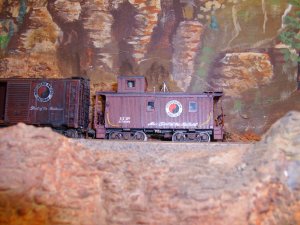

This is an Athearn 5 window Cupola Caboose kit bash. Many changes to the kit where performed to get it looking like a Northern Pacific 1000 to 1050 series steel caboose. These where the first steel cabooses that the N.P. had. It's my understanding that the crews really did not like them as in the winter they where cold! To build, I removed all the rivet detail that Athearn put on the model. Then I filled all the windows that where not in the right positions, I also had to add a small window that would have been in the bathroom. Then, the cupola on the N.P. caboose was farther forward of the position on the Athearn caboose; so, I had to move the cupola forward and fill in where the old hole was. Then, because N.P.'s cupola was as wide as the lower part of the caboose I had widen the cupola and because the N.P. cupola was taller than the Athearn, I had to add material to make it wider. The end railings had to be fabricated as the N.P.'s railings had much more railings on them. Finally the roof platforms and ladders had to be moved over to the other side. I added a man visible in the cupola and painted the caboose Mineral Brown and decaled and gave it the number 1001.
It was a fun project and took a while to complete. I have another Athearn kit, I will eventually make into a 1051 to 1100 series caboose, basically the same as I just described only the cupola is lower.

I really like the cabeese. You did a really nice job on them. I should build a few more NP cabooses as I already have enough for the Milwaukee Road on the layout.

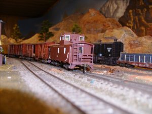

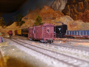

These two cabooses are Gloor Craft Models wood kits. Gloor Craft Models is no longer in business; however, I have been able to find them on Ebay and typically end up paying between $20.00 to $30.00 for a kit. In fact, right now one is selling on Ebay for $24.99 "Buy It Now". Do a search for Gloor Craft Northern Pacific Caboose. I have one more of these Gloor Craft kits to build and I also have an Ambroid N.P. caboose to build. I would assume that Gloor Craft bought out Ambroid as the two kits are the same, excepting I will have to cut out the windows on the Ambroid model. I find these wood kits to be really fun to build. The one on the left is the first one I built. and I can tell this because I put Visors over the Cupola's side windows. The cupola parts are pot metal along with the window frames, End platform steps and brake details. Again the end railings are details I scratch built from cardboard and plastic angle irons. Grab iron materials are provided and made from both brass and soft steel wire.

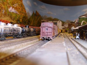

The NPRHA was offering a Bay Window wood caboose kit a couple years ago. So, I broke down and bought one. This is the only Bay Window caboose I have. This was a tad more difficult to build than the little 24 footers. As I remember, there were no metal parts for this caboose and the brake rigging was from Tichy. All of the wood kits I have built come less trucks and couplers. However, if you want real looking Northern Pacific Cabooses and don't want to pay for brass, this is a good way to get them. I don't know if the NPRHA will ever market the Bay Window again.

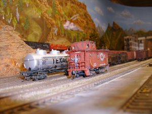

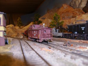

This is the last caboose I am going to show. It is an American Model Builders Laser Kit, modeled after one of Northern Pacific's 1200 series cabooses. This was the first wood N.P. caboose kits I have built and by far, the best of the wood kits I have built. Although the kit costs around $50.00, it is well worth that price. I do not recall if the brake details; or, other detail parts are plastic; or, pot metal and I don't think it matters. Most of the parts have sticky backs to aid in assembly. The kit provides all parts, including clear window material. The cupola is also wood. It builds into a very nice kit. You would need to supply couplers and trucks.

Nice looking caboose. Send it over. Grin.gif May have to see if I can fine one. By the way, the ground level photos are a big improvement. What you may want to do is to add some additional lighting. I have a lamp with a clamp on it that I use for additional lighting.

Nice looking caboose. Send it over. View attachment 58996 May have to see if I can fine one. By the way, the ground level photos are a big improvement. What you may want to do is to add some additional lighting. I have a lamp with a clamp on it that I use for additional lighting.
What you see is what your going to get. As I explained, I am not interested in photography and I really don't like these angular shots that don't show the subject to the best ability. Not being cranky, just stating what I think and that is that a shot from above and broadside shows this much better.

No problem. Just saying that the photos do look more realistic at a lower level. I have been an amateur photographer for years.
