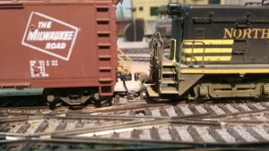

The core of the issue is the S curve ya have going there. Shorter cars and locos would negotiate it easier. If ya look at the mechanics of the couplers you will see that they are pressing hard against each other as the loco is still making a left turn while the car is going through the right turn.

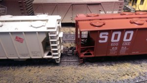

Paul - Here is a photo of a #158, on the left and a #5 on the right. There is a slight difference in the height of the coupler.
In the next photo you can see the slightly smaller size of the coupler with the Kadee Covered Hopper on the right with the 158 coupler and the car on the left with a #5 coupler.
I haven't had any problems with them as I had stated before. My layout was built as a switching layout and I do use the Kadee magnets for uncoupling as some industrial spurs are a fairly long reach and I don't particularly like reaching over scenery. The most important thing is to have the couplers properly adjusted using the coupler height gauge. I am anal about that. One thing that I do before installing Kadee couplers id to take a fine file and file across the front face of the coupler as there can be a bit of flashing on the face. Many of my freight cars have been around for over 30 years and I have had almost no problems at all with them with the exception of a clip holding the coupler on on some of the old blue box kits. If that does happen, a 158 is installed.
