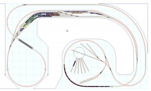

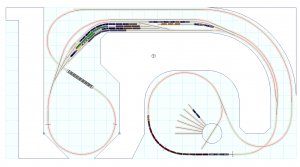

OK, so after spending some serious time with 3rdPlanit and getting some one on one coaching (Those curved section of benchwork were a bit of a challenge to lay out) I've come up with a very rough interpretation of what I think you've drawn.
A few comments...
1) That lower right corner gets gnarly when you try and keep your 30" radius curve. I did it but it was tricky.
2) As it stands, this would be a very photogenic, and extremely boring layout. Run trains in circles and switch the yard. That's it.
3) That yard takes up a LOT of space. The left side is #6 turnouts, the right side is #4. I also managed to fit in a small engine/caboose area. You could even fit a small yard office between the tracks in the opening.
4) That long sweeping curve is both gorgeous and problematic. That double track on such a wide radius will look wonderful. Again, great for model photos. But it's an awful lot of space with absolutely nothing in it. What did you have in mind for there? When drawn to scale, it gets pretty long and narrow...

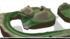

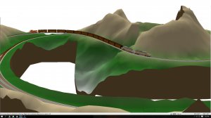

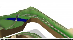

Check out the videos section, I've just posted a 3D rendering of the layout from 3rdPlanit. Looks pretty cool, and there's lots more to do.
Ok, so we now have the basic outline sketched in. It's time to start locating the important features. The largest ones go in first, since they take up a lot of room and typically can only fit in a few places.
One of the items mentioned was a turntable. Turntables and roundhouses are very cool, no doubt about that. They're also very large and take up a lot of space. Looking at the plan, it really seems there is only one option for an area big enough for a roundhouse. It's also trickier than it looks at first glance, as you have to get a switch off of the main track to connect to it. I suppose you could custom build a curved turnout, but I opted to drop a #6 turnout into the straight stretch. You could also have it come in from the right side, but at the moment I have that shown as a bridge, which means it's not a good place for a turnout.
I can probably move that around a bit and make it work better.
However, you've reached a point where you really have to set your priorities. How much space you are willing to dedicate to a roundhouse? Is the yard too big or too small? Do you want sweeping vistas, or do you want lots of switching? Your goals will make a big difference here.

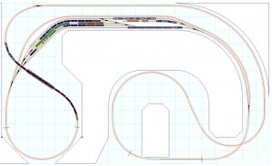

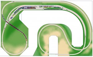

View attachment 56370View attachment 56371View attachment 56372
A few comments...
I really haven't drawn any of this. I came up with a few basic concepts and members here took the ball and ran with it, tootnkumin drew the sketch you are working from now, Iron Horseman drew up a number of sketches, with different options. And other members have added their thoughts. I must say you are all way ahead of me.
I appreciate your time and effort. The result is so much more than I could have done on my own, and it isn't even built yet!!!!
What would you do to make the layout less boring? I do like the long wide curves, I want to get some big steam locos they will look great on this layout.
The yard does take up a lot of space, but I like it.
I could dress up the long curve with some trestles, they would be fun to build.
Again you guys are way ahead of me, you are doing such a fine job, I am happy to have you get creative and add the features that will work and that you think would make the layout enjoyable to run trains on.

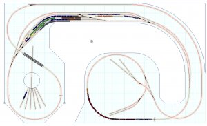

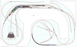

Roundhouse version 2.0
The more I looked at the first version, the less I like it. If you're going to use that much of the layout for a roundhouse scene, the roundhouse should be front and center, with the classic view looking into the building easily accessible, not hidden in a corner. So I've rotated the turntable (which is scaled to the Walthers 130' table) and roundhouse tracks. I've also added a couple of tracks in front, for service and ready tracks, these would have coal and water towers etc, and be used for quick service stops. The two tracks in the back are intended as either a back shop for heavy repairs or a car shop, your choice, or any industry for that matter, but I was going for the railroad terminal look. (Ignore the funky scenery in the back, I haven't figured out how to blend the two meshes yet, so I didn't adjust. If you go with the roundhouse, you're probably going to have cut there and a short tunnel rather than a big mountain.)
Looks like we are simultaneously posting.
Speaking of bridges. Is there any reason the big bridge and river could not be switched with the round house? Put the round house just off the yard, and move the river to the other island?
That's an option. You'll still need some kind of bridge, as the track has to cross over. But it could be a trestle for the most part.
The only thing I don't like is that if I move the river to the lower right corner, then I have two bridges criss-crossing as they go over the river. That's not as realistic looking. Yes, it happens, especially in places like cities, but it's not as "natural" looking. The river also gave the yard a reason to curve, following the river and the hillside.

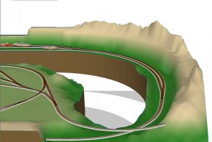

So, I did two things. I move the track away from the edge of the benchwork a bit, to allow for a more natural edge. I also hid the upper track in he mounts.
The problem? It's only 2 feet wide. Add in a couple inches from the edge, 6 inches for the double track, a couple inches for the upper track, and you have a nearly vertical cliff trying to create enough cover to hide the upper track.
I see two options here.
1) Do a quick mockup and see how bad it actually looks. Just a short section, scrap wood or cardboard, to see if it would work.
2) Hide the upper track behind a backdrop. For example, an outline of distant mountains that you put behind the trees on your now less steep hillside. Personally, I think that may be the best option.

I don't think the steep mountain side is bad at all. It is like the going to the sun road in Glacier N.P. I'm sure there are trains that disappear into mountains with steep sides. It would be cool to have a spot on that hidden track where the train emerges from the mountain and goes over a trestle.
I still like the idea of a steep mountain, I just don't think it should be too steep.
As for emerging from the mountain and crossing a trestle, that's exactly what I was thinking for the highline track, as you can see in the foreground.

Let's go crazy - Level 1
OK, we seem to have a lot of goals and ideas, not all of which are compatible with one another. It's not possible to yards and roundhouse and industries and towns while also doing wide sweeping curves, mountains and big vistas. Well, at least not on a layout this size and on one level. So.... I decided to pretty much start over, and go with a two level plan.
Now, before you think I'm totally nuts, consider this. The bottom level, while large, is actually quite simple. It's just a big folded dogbone. When completed, the tracks would connect to the upper levels, but for the first phase, you could temporarily connect the two highlines and have a layout that you could run trains on. Not a very interesting one from an operational point of view, but a great place to learn the basics as well as a place for some amazing scenery.

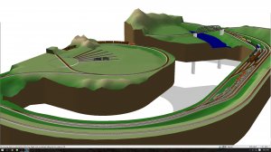

Overview, lots of scenery and big curves.

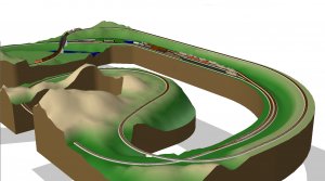

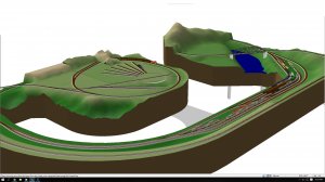

Left side of the layout. Kept the river and bridge, got rid of the yard. The two tracks in the center would be a coal mine. The short stub would be a team track and the wireframe is a station. With a section of double track, you could have meets and also allow freights to pass while a passenger train was stopped in the station.
Right side. Huge mountain scenes and big trestles, inspired by the likes of John Allen. A large trestle right behind the engine, and then a second large bridge over the valley to the left. If desired, that could be a canyon as well, and the lower track would also have a bridge.
This level would be for running trains and photography. Maybe timetable operations with a passenger and freight, but to be realistic, there's not a whole lot of operational challenge here.

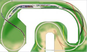

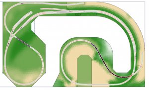

Let's go crazy - Level 2
Here's the second level. At the moment I'm re-thinking which level is on top. I suspect it would be this one, but that could change.
This is done quickly, but it gives you some idea.
There is one potential issue. The big S curve on the left is the track coming up from the bottom level. Where it crosses under the roundhouse lead you need vertical clearance. Then it has to climb up to reach the yard. Yard should be level, or even bowl shaped, but it's really not good to have the ends drop, especially on model railroads where you can't set the brakes on the cars. So that point need to be level. It's going to take some creativity in that area.
