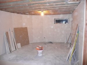

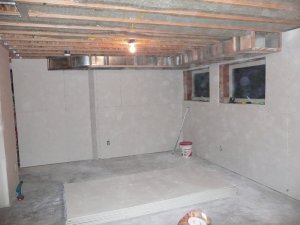

Getting stuck into it eh! Looking at the ceiling (or rather the floor above) it looks like it's sheet flooring on the joists, if it is tongue and groove, then a sheet ceiling will be needed to stop dust. If it is sheet, then you could do this.
Go down to Post 49 http://www.modelrailroadforums.com/...ired-from-my-old-Central-Midland-Layout/page5
Yes plywood sheeting above on joists. I was planning on putting up dry wall on the ceiling anyway. The wife wants sound insulation between the floor joists so "I don't have to hear your trains". I don't blame her. So the dry wall will go up to cover the insulation.

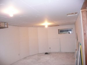

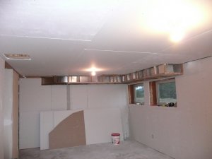

I always frame it with my fingers, go to the sheet and visualize the general lay, saying to my self that this hole needs to be here. Just put an x there. Check to make certain I'm looking at the correct side of the sheet (cutting from front or back). Once I have my X's on, I do the same in reverse. Pretend I pick up the sheet and move it where it goes. Hopefully the holes line up. If not then I do it again. Once I know the X's are in the right position I actually start measuring for their exact real spot. I had one last weekend that had 4 special cuts in it - groan.I never did figure out how to keep the holes and angles I was cutting from magically appearing on the opposite side of the sheet that they were supposed to be on.......

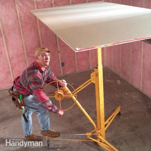

I love my drywall lift. Sure does beat using manual deadman tools.I rented a dry wall lift, it made the job doable,
I did finally figure out how to do it. When cutting a sheet for the ceiling lay it under the spot where it goes and orient the sheet where it will fit, then make sure you measure and cut the back side not the side you will see when you look at the ceiling. Then raise the sheet to the spot where it goes. If you made the correct cuts, it should fit.
Yep, pretty slick tool.
The part I hate is the taping and mudding.
That starts tomorrow.
