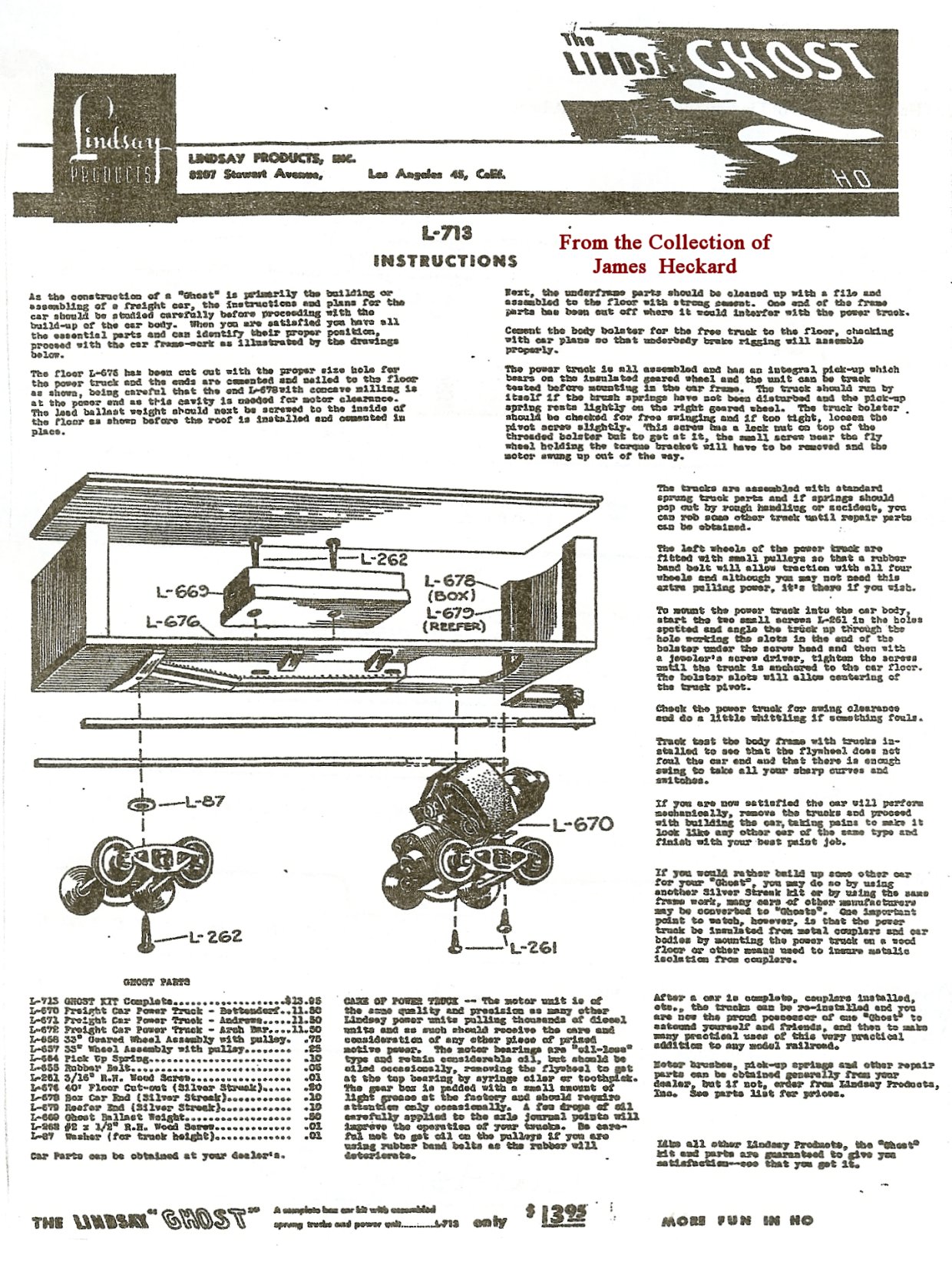

Regarding a "powered" boxcar in HO, this was done commercially many decades ago by Lindsay Products. Referred to as the "Lindsay Ghost", I believe it was a take-off on a car John Allen had on the G&D. In addition to being used as a mid-train helper, John employed it to startle the heck out of visiting operators when, under John's control, it would suddenly take off down a siding as if a runaway! As I recall, the model was powered by a single old bulky Walthers power truck of the sort used on their MU cars. The Lindsay kit for this wooden craftsman boxcar is rare today and highly collectable.
http://www.hoseeker.org/lindsay/lindsayghostcar.jpg
