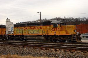

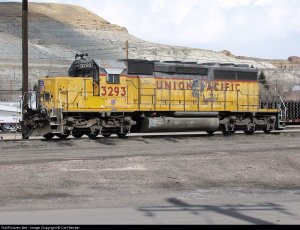

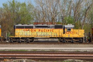

I'm looking to weather a loco like this one. It's a up sd40-2 snoot. I'm just wondering on how I should go about doing the graffiti job on this loco. All recommendations are welcome!

That graffiti has been painted over. So it shouldn't be too hard to mimic. Just do as mentioned and get some markers and try to put down what looks close to the graffiti then cover it back up with the wrong color yellow. Piece of cake.

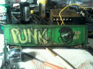

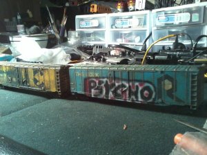

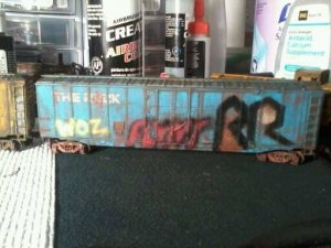

didn't mean to duplicate those.
or these.
Wow, great job Mike!
Sent from my SPH-D710BST using Tapatalk
Those are really awesome.
