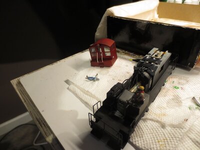

Also, took the SW-1 apart and added an operator, also did lube work as it was disassembled"
The operator is in the cab, also put the other man on back holding on

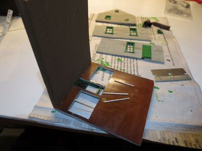

After getting the picture windows done, I glued all the sides together getting ready to make the roof sections. They included templates for this, I painted theunderside of all the sections, as well as the interior of the building, which will be lighted

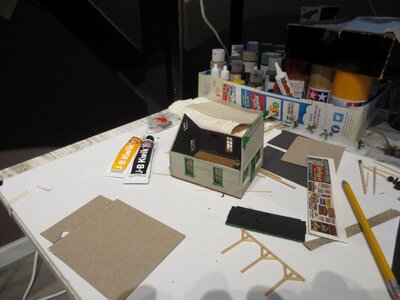

Getting to the home stretch for this project, the interior has been painted also put together the porch roof also the supports. The corbels have been attached and a narrow trim piece on top of the false front, will be a trim piece up there as well,
Hard to see in the photo but I glued a couple women inside the right window also a small table on the left side, light will be coming out of the floor towards the back of the building

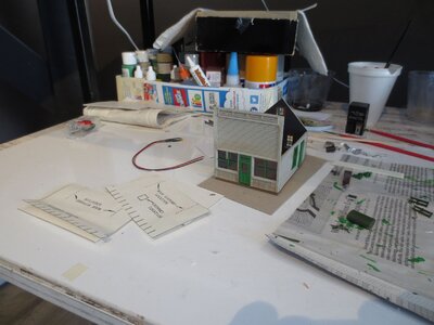

I have a few pics of the buildings I have been working on, finally got the grocery store on the layout with some of the scenery around it...
I have the interior painted, used JB weld around the floor to make sure light does not bleed out, roof sections are cut

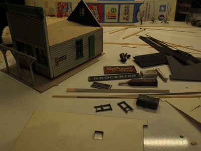

I put a ceiling in place, used JB weld on the end seams, otherwise adhered with gorilla glue to the wall sections, the sign boards are just reinforced cardboard with a wood edge, oil tank, other details ready to assemble...

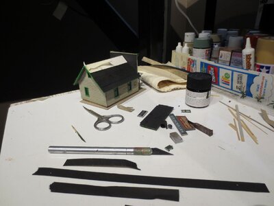

For tarpaper I have some paper towels with flat black spray paint, cut into scale 3' wide strips, being applied bottom up. I used gorilla glue to adhere the tarpaper as it adheres almost instantly and is really strong. Note porch section will be applied last so I don't mess up with handling

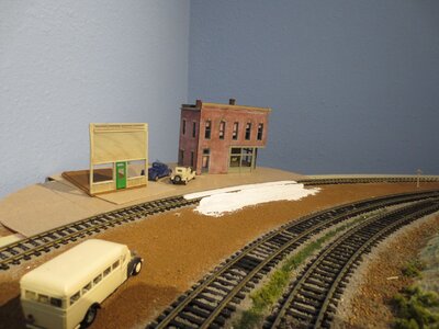

The building is complete and on the layout. Scenery left to do otherwise I like it! Will be some people around also a couple cars. The hotel/restaurant still not detailed, have some scenery areas to complete there otherwise thinking on the backdrop...

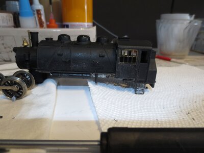

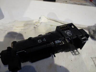

Fixing up the little Rivarossi tank loco turned out entirely different than what I imagined. First I ran into this problem, the numbers and insignia for PRR were raised letters, and did not want to come off with the finger nail polish remover which is my go to:
Above, after rubbing with a generous coat of fingernail polish remover, barely scraped the paint. Then, when I turned it over to do the other side there was some sort of reaction with the cotton cloth and it left a little pattern on the plastic :mad:

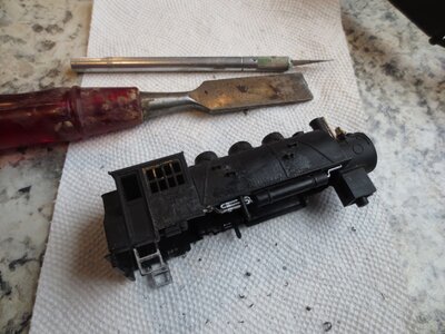

after some thought, what about a little heat, maybe scrape off the offending numbers. My original plan was a road decal where the PRR is and a number where the 84 is
I heated the chisel up on the gas burner then worked gently to scrape the numbers and letters off, then decided to make it look like a beat up loco and go with it
here is the other side. the impression of the cotton cloth was smoothed out some with the hot chisel, also decided to do a little additional distress. I cut off the bell and put a metal one on as well. Also, added some weathering powders and coated with Testors dull coat
