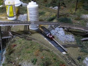

On a section he had not finished were some very expensive clamping devices. He, like me, builds his bridges in place beneath the track. It is trickier, but very rewarding when you look at the completed project. That said, I thought I would post an informative photo that show how I do my clamping, and propping up.

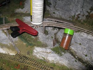

Here we see the poor man's clamps and props. On the left a stick from the park across the street to hold the log in place. Next is a chip clip device that holds the wood to the track while the glue dries. In the middle is a glue bottle for weight, on the right is a small shaker bottle to prop up the upper log and hold the log beneath the bridge.
What I'm getting at is the necessity is truly the mother of invention. Give your layout construction the "McGyver" treatment. Save some money and have a feeling of satisfaction you may not get from some $14 clamps. Jim

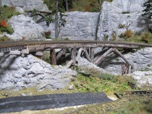

You've had some sneak peeks of the new bridge. Here's the finished product. As usually since it is on private land out of control of 1931 Alaskan regulators is it built from logs by the miners and lumberjacks themselves. This one is more involve, but I know it will hold up the 'load!':eek:
The bridge from the tipple will be a more typical trestle bridge because it crosses over a mainline track. Jim
This one is from another angle. Notice the trees are magically reappearing. Jim

Very cool!
Now I'm trying to figure out how to add a bridge like that into my layout. My to-do list grows every time I look at photos like these....
You'd better make sure that twig supplying tree in the park across the road gets watered and fed and generally well looked after, Jim. Can't be too many that grow such scale model railroad specific twigs like that.
Amazing, simply amazing:cool:
Kind of a weird question but what type of twigs are these? What tree are the from? Im guessing you only use one type of twig?

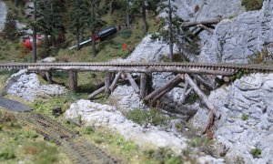

Here is the finished trestle work (nearly finished!) to the ore tipple. Scenery is back in place and the corner of the nearly destroyed ore tipple is put back together.
Photography is a very effecient way to check your work. I checked the trestle bents a number of times to see if they were correct. This 'checkup' photo shows they are not. One piece failed to connect and slid down its hole. Don't know how I missed it??
Now I know what is wrong and I can fix it in 30 seconds. I'm glad some sharp eyed guest didn't notice it this weekend. Jim
Apart from the little "hiccup" you've pointed out (may not have even noticed) that is another fantastic scene. One of the things that makes it look so real is the treatment you have given the timbers of the tipple, the colors just are so right.
Thanks Toot, All is repaired now. As for the tipple. All the wood was dyed with weathering solutions. After that some wood would get an extra dip. Some would get a light brushing of brownish color. I assembled the tipple with no regard as to color.
