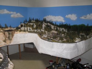

Tony, Another good question. I did not follow directions on the packaging. Normally I overlap maybe 30%. This saves money without sacrificing much strength. Now if I was building a layout for a museum or a rich fellow like you you can be sure I would overlap these cloths. I am not worried at all about the fudging on the steep sides, plus I wanted to show the area one package would cover, in the best of circumstances of course. I've found that after Sculptamold dries and cures that virtually all the webbing and plaster cloth is not even needed. Sculptamold is quite strong in its own right. Actually, I pulled out most of the webbing and plaster cloth from under the mountains to help with train access. Nothing has fallen down yet! Jim:)
Hope your efforts of applying goop to vertical surfaces is better than my efforts to fill joints in drywall. Plenty of paper on the floor otherwise.
Toot, No worries about sagging goop. Sculptamold is perfect for the vertical walls. Just let it dry in the bowl for and extra two minutes and apply. Best stuff I've found for vertical modeling. Jim:)
Like me, you use plaster cloth to "hold stuff together and as a platform only", and that makes very good sense in my opinion. That is something I should have remembered from reading your post.
I did my first layout using plaster cloth only, not only did it become expensive BUT, even following the instructions, the strength it provided was minimal at best. That is the reason I went to plaster of paris, only using plaster cloth as a foundation.
A quick "hijack" for one second - either your mud is too wet or too dry or you are putting it on too thick. Two or three thin layers should stick to your joint tape without falling off. One other tip, put your mud on from bottom to top.
Sorry for the hijack Jim - wont happen again :)
Tony, No problem. Good insight. Bottoms up will almost always do the trick!:eek:

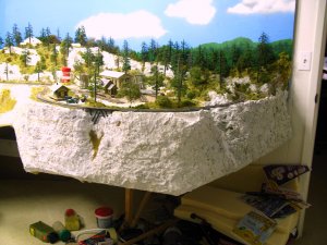

Here we have the last of the plaster cloth. Next is Sculptamold. Jim:)

In the meantime I have just finished the canyon wall Sculptamold applications. Not finished with coloring and planting until next week. I have family coming in and work on the layout will be scarce for a couple of weeks. Plus, my wife, Gayle is having a cataract operation on July 9. Busy me. Jim :)

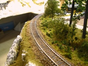

Here's an example of what I'm talking about:
It looks like you could 'eat' off this scene! If your layout mainline looks like this one and you intentionally modeled it so, then, of course, you're not wrong. We can assume you've done your homework and modeled it they way you see it. Hopefully, you simply didn't just plunk down your track ballast it, used a piece of thin cardboard to protect the ballast, sprayed glue and then shook your favorite green ground cover down to achieve this scene without study. I'm hoping you did the former, but when I see the rest of some of these layouts I have some serious suspicions that shortcuts may have been taken.

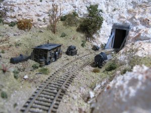

So, basically I would like to see modern layouts look less like the photo above and more like this one:
Later, Jim:)

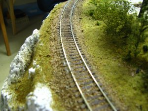

For you modern modelers I offer this solution to a more realistic look on your layout.
I used some heavier green ground cover, a shake of Woodland Scenics 'Yellow Grass' and some spray glue. Two items, total time less than one minute. If you like the look of this photo better than the previous one then good for you. If not, there may be no hope!
Remember, I made these small additions for you modern modelers. Not much really no effort. So if you like this 'modern' trackside look then give it a try if you need to. Maybe encourage a friend to add just a little bit. Jim:)

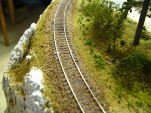

Finally we come to the era of pre WWII. Things were changing in our lands at this time. The Great Depression was over. Europe was an uneasy place to live. Mainline railroads around the world suffered during the Great Depression. Junk laying around, track projects underfunded and not finished. This next photo shows a mid-thirties mainline. I've left the left side of the tracks undecorated to you can see the changes on the right side better.
If you've read all the words and studied all the photos you may have noticed that as we go back in time on our layouts scenery tends to creep closer to the mainlines. Check out that BNSF pic earlier in the trees and even today all is not too clean on modern mainlines.

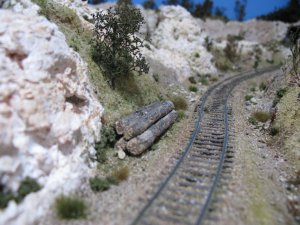

Lastly don't forget to use different types of vegetation, rocks, etc. around your layouts if you model in changing seasons or even elevations. Here are a few ideas for Next to the Track:
Done. Jim:)

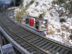

Next up is the final pour on the water scene. I made four pours of WS Realistic Water, any water will do of course. Now you see the Modge Podge layer of water. Modge Podge is simple to use. Just pour it on and after about and hour I make 'waves' and ripples. What you see in the photo is after 24 hours of drying. It goes on white but clears somewhat after drying.
Also, in the photo you can see rivets in the tipple. Under the tipple you can see minor ripples. Underneath I applied the Modge Podge with a teaspoon. On the dock I've added some used oil drums. Looking at the scenery you can see a finished job on the the land. Scenery in the front of the layout takes a long time. I look at the layout area each day and a day seldom goes by where some bush or tree is not added. See the floating oil drum and seaweed? These things help out the over all effect of your scene. Jim
