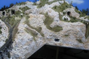

I'm getting pretty excited now. The last of the rock towers and cliffs are dry on the left side of the layout. First ground cover has been applied and all of a sudden the layout is 90% finished! Note also the DCC plug is a bit more subdued. Jim :eek:

Jeez Jim, if you were to dab it with a little bit of paint it might disappear altogether!
Of course your operators wouldn't be able to find it!!:p

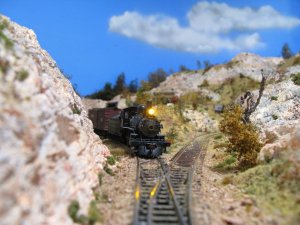

Here is a an update photo of the 'desert' area. Actually running trains here! Just some track work to get the kinks out to go. Jim :)
Thanks fellows. I don't think I've found the right lighting yet.

Next week I will introduce a photography and technique study about "next to the track" scenery. I think one of the most overlooked scenery areas I've seen in my days is the two inches on either side of the tracks. Stay tuned probably Tuesday and I'll show you how easy it is to be quite convincing on next to track scenery. Here is another photo showing, on this layout, "next to the track" endeavors. Jim :D
Waiting with anticipation, Jim.
I like to see lots of detail next to the track .. Buckets of spikes, ties (both old and new) rail joiners, and sections of rail.
From my observations .. These are overlooked on most layouts.
Seems to me that "modern" railroads police the stuff better than in the older days. Back in the 40's and 50's, stuff was scattered all over. I am sure that you have something special in store for us?
BTW .. Nice photo!

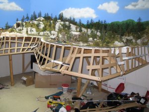

In the meantime with the layout more than 90% completed here is a picture of the 'skirting' around the bottom of the table top. Because of my photography jones, I've become disenchanted with fascia board over the years. In fact I now officially Hate them and I will not give in to any hardboard temptations. So this photo shows framing of the canyon walls. Jim;)

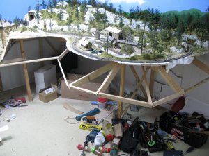

Update photo shows webbing attached. I use hot glue for this job. Next plaster cloth. Jim :)
Sherrel, Not a stupid question at all. Early on in this Southern Division layout building I mentioned that I did buy a box of pre-cut cardboard strips from MicroMark. I really liked them. Interestingly enough last night sitting in my workbench chair with Evie the cat on my lap I thought, "Gee, I wish I had some of the pre-cut strips for the next step." So no, I cut these myself. Cheaper for sure. Jim:D

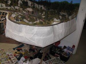

Here is photo showing what one roll of plaster cloth will cover. I though some of you would want to know. What you see is basically 6 ft. by 15 inches. Cost 8.75 per roll. Total rolls use on this layout is around 25. You can do the math. Jim:)
That certainly looks a lot better than a fascia board - finishes things of naturally, great job. One question though, do you overlap the plaster cloth by 50% for strength?
