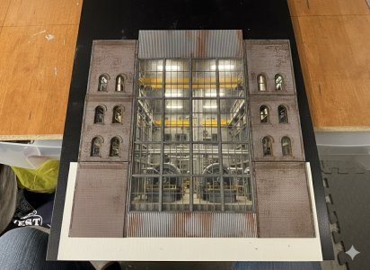

No it’s not the #3 power plant wall nor is this the front curtain wall! It’s a Bunker C oil tank. I’m told when power plants in the olden days (1965 here at the power plants) restarted the boilers they used oil and particularly very dirty Bunker C. So my friend found a tank kit to use.

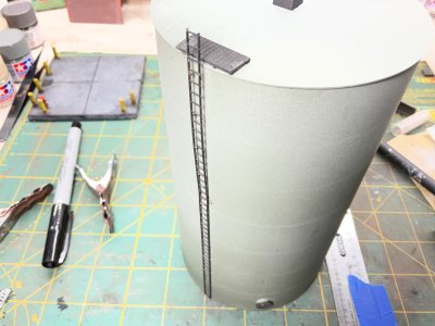

Tichy #7013 water or oil tank kit. A kit someone started and gave up on! He purchased for cheap like $5.00 cheap and figured someday he’d use it! Well whoever started the tank cylinder had no clue, the directions while minimal give enough info to assemble it. The person must not have been able to read! Tichy offers the kit with 2 roofs a flat and a conical, only the flat roof was in this box! There are 2 options to get to the roof. A very delicate ladder with safety cages up the side or a spiral stair case which is what I chose. Then found out a main support sprue was not in the box. So a flat roofed oil tank was my choice! With a straight up ladder. I didn’t use the very sweet looking safety cages as this was 1965 and OSHA was signed into law by President Nixon in 12/1970. So it’s doubtful there’d have a safety cage on this ladder. Besides looking at the safety cage pieces, many pieces of rod were broken
Disassembly of the tank cylinder was a must. Thankfully it was assembled with some sort of white glue. A little water, a hair dryer, more water and lots of patience I had all sorts of side wall parts to clean up.
While not perfect I put the tank back together.
We needed a base to start. 5” square
Test fit
Paint
turns out its way to green, toned it down with a earthen color mix to lighten it up
Add the ladder and a landing spot
Change the center vent
Add a fill overflow pipe
Remove the overflow vent pipe and add 3 Inspection hatches
Lock it all in with a matte clear finish and let it dry
