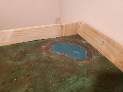

When you flip the panel over, the foam can be carved out into a pond or lake.
Here is the finished scenery panel with the rocky hill on one side and a lake feature when flipped over.

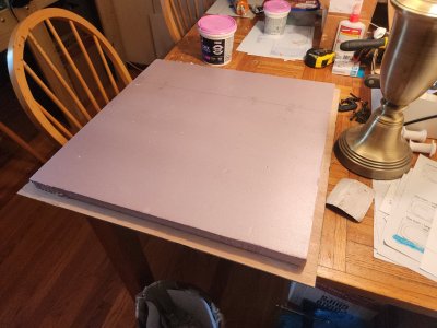

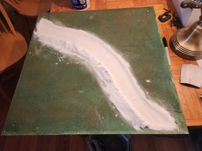

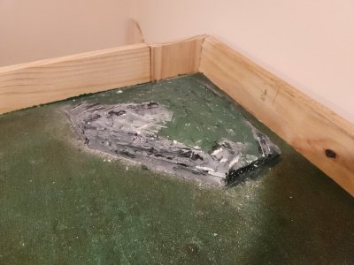

We relocated the lake terrain panel to where the coal mine will be and removed the corner panel to start creating the river panel for the location of the coal power plant.
We moved the panel to the work table where cut out the river, attached insulation board and sculpted the river terrain. It's almost ready for painting.
The insulation board can be flipped over and used for a new terrain panel in a future layout with a different theme.

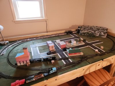

Before my grandson comes over i remove all the buildings and scenery and i let him set it however he wants...see attached picture.
We ran trains between the coal mine and coal power plant stopping each coal car under the hopper one at a time.
I showed/explained to him the basics...sidings, spurs, local loop vs mainline, how to unhook cars using the bamboo skew, etc.

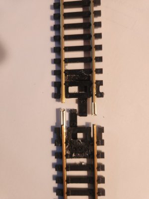

The only problem with frequently changing the track plan is the track will separate causing derailments. So to fix this issue, i designed a latching track clip and had them 3D printed.
I then attached the clip to each end of the track track using gorilla glue.
It really works good.

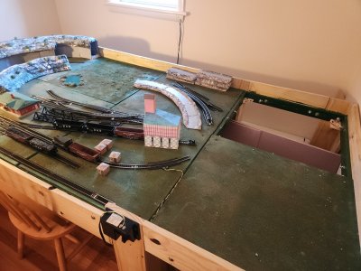

My grandson has trouble reaching the center of the train board so i rearranged the 2'x4' frame modules so there is an opening in the center.
After we get it all set-up, there is an edge along the 1'x4' opening where we can stack pink insulation board and carve a mountain.

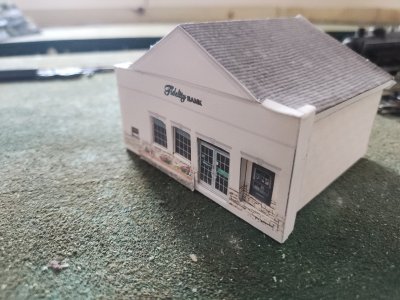

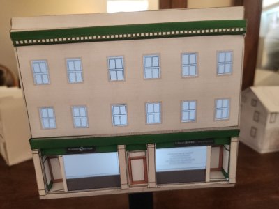

I started making houses in town. This is an HO scale of my bank.
I first attempt was S gauge since its easier to work with the larger size. The bank manager was surprised when i walked in and handed to him.

I also finished my 3rd building of my town; Blackbird Antiques. I delivered the s gauge version to the owner and he was absolutely blown away!
I used tracing paper for the windows so i can light them up.

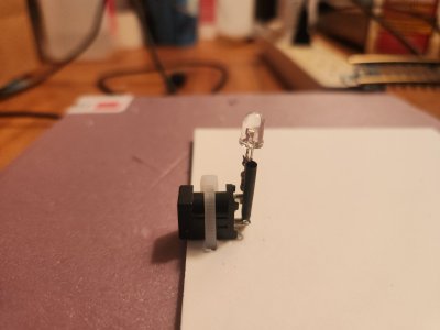

Ive completed 8 paper buildings of home town businesses. Now i am adding LEDs.
I found a 5vdc barrel jack receptical that i tie wrap to the base of the building then connect/solder a 3.2VDC LED with a 91 ohm resistor.
The barrel jack makes it easy for my grandson to move buildings around.
I also found a USB to 5VDC barrel jack cable so i can use a standard USB charging block.
