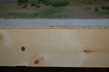

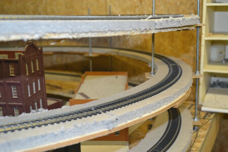

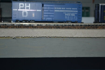

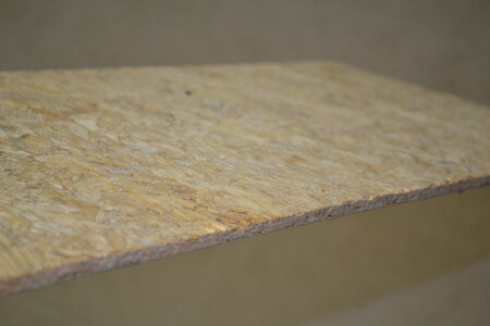

I used 1/4 in OSB with 1/2" homasote on top all on 16" center 1 x 4 Even used some homasote by itself on 1 x 2
Made two helix same way no problems
never had a sag anywhere was up for may years
So unless you are going to be climbing on it 3/4" is way overkill
