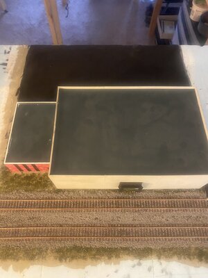

Thanks, smudge! All the track in this scene is done and has been glued down for several weeks if not months. I've never had a problem. Since applying the Smooth-It across the tracks I've made a space for the wheels of cars and I've run several cars and engines across without any issues.
I certainly don't want to cause myself any headaches by rushing but I'm curious to see how a nearly completed area (however small) will look. Does this info change your mind at all or are you thinking of something I'm just missing?

If your happy with it, then go for it. I haven't ballasted mine yet simply because I've never really been happy with it yet, I always find I'm altering or adding something, and it's easier to move track if it's not ballasted.
Thanks, guys. The track seems bullet proof in this area and the structures fit exactly as planned so I think I'll go for it.
Just nervous about painting the inside of the rails. Don't want any conductivity problems but if others do it getting electrical pick-up from the tops of the rails only is enough. I'll paint a small section of track, let it dry and test before ballasting. Hopefully get to all that today or tomorrow.

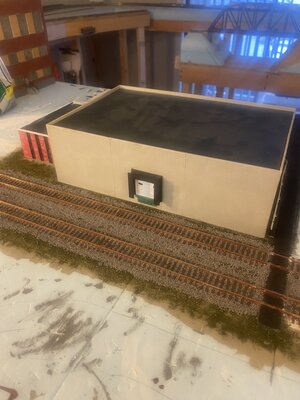

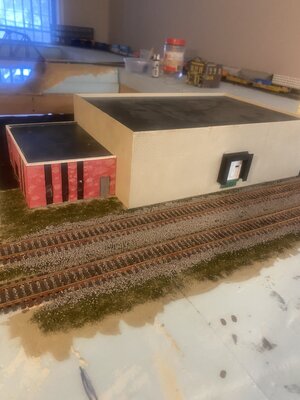

Well, this little bit took longer than I thought. I made a parking lot and walkways, painted the ties and rails, and added a little ground cover and ballast. Not perfect but I'm pretty happy with it. Maybe I can do a little touch up but I'm moving on to something else for now. I still have track which is not glued down and feeders not connected!
