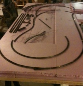

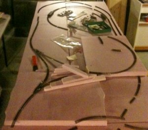

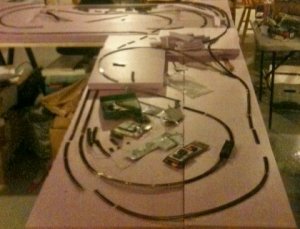

I've been chewing on this one a while. What's old is new again. The purpose is to lengthen the mainline, and provide some scenic interest.
Earlier this Fall, I bit the bullet, and decided to attempt something of the same concept, only on 2 HCDs(Hollow Core Doors). I'm still considering how to integrate it with another 4'x8' D&RGW layout based on a plan in 101 Trackplans. (Denver & South Park). At this point, I'm looking at using more 19" radius sections, as I have them left over from the previous layout. Here are some photos:
Left top photo: Area of Keddie Wye. Includes section of the 'High Line' to Beiber, in addition to mainline to Orroville. High line may join the Oroville mainline in a the tunnel under High Line curve.
Right top photo: Area that includes Keddie Yard, and run portion of Feather River Canyon. Lower left corner will be Reno Jct. area, with view break from Keddie. The middle portion of the door may have a number of bridges, and trestles, running thru a canyon. Unfortunately, railroad may be on both sides of the canyon, with road and river at the bottom , in the center.
Bottom photo: General orientation of the 2 HCDs. May shift forground door to the left, instead of it being on the right.
I'd like to place a couple of sidings along the mainline in places, to give the trains places to meet.
Ideas/thoughts/comments/suggestions?

I find your plan "C" rather interesting but as earlier posted, none of your choices will fit on a HCD. I like the wye idea.
