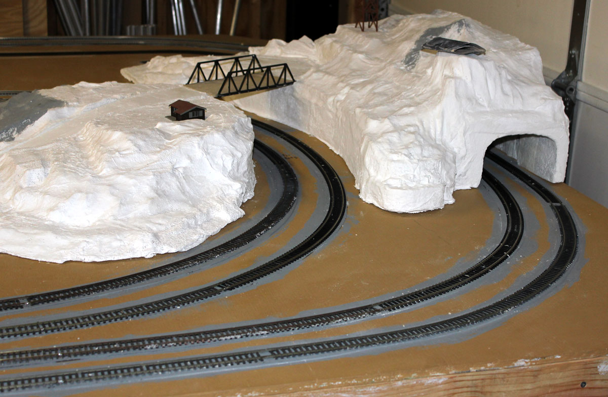

I have a homemade tunnel that needs a 5-1/2 to 6 inches wide portal. This is because of the track spacing and because the tracks start to curve exiting the portals.

What's an easy way to get something 4" high and 5-3/4 inches wide that looks good??

Is there a special type of foam board that I can get that I can carve lines in to look like stacked cut rock? I was thinking of using a clay glaze. This is what the portals look like now:
