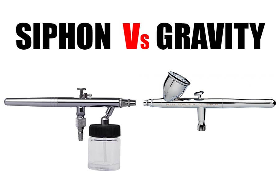

Or this one. Everything the one above has less the paints and supplies.
Hard to say. The one on Amazon has good reviews, but it's hard to know what's reliable with those anymore. I wouldn't give the included paint too much weight in your decision; it may be fine for practice, but there's a fair chance the type of paint included is not the most ideal for hobby (i.e. painting railcars) purposes. Most compressors have somewhat standard connectors, so once you have that, you should be able to use different airbrushes you might acquire in the future with just an adapter or different air hose.
On the second one, Paasche are certainly popular, but I've never owned one so I can't give you personal experience on that. Keep in mind, that one appears to be a single-action airbrush. If you don't already know the difference:
-Single action means when you pull the trigger or push the button on the airbrush, both air and paint come out simultaneously. Cheaper, but you cannot control paint flow. The only way to control paint weight is by thinning the paint itself.
-Double action means you have separate control of the air and paint. With most of these, when you push the trigger down, the air starts flowing. Then as you pull the trigger back, you control the flow of paint. The more you pull it back, the more paint you get coming out. Much more versatile, but of course more expensive.
One other difference I see is the first one is gravity feed and the second is siphon. For your purposes, that shouldn't really matter. About the only reason you might consider siphon is if you ever see yourself needing to switch colors on the fly. With a siphon, you just pull another jar out and attach it. On a gravity feed, you need to empty the paint cup, clean it out, and refill with your next color. To me, it's not a big consideration, I rarely find myself needing to switch colors in the middle of painting. There are some other advantages to each, check the following out if you want a more in-depth explanation:
