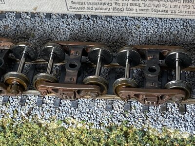

Today, I tried using the airbrush on 3 pulp cars. Just a base coat of light rust on the deck and the underside of the cars. Definitely quicker and even but not sure I will do it again. I really like how the decks of my previous pulp cars had worked out. So as a base I am happy but the finish on these cars will be by hand. The 3 pictures
are 3 seperate pulp cars.
The wheelset and trucks are by hand
Constructive criticism is welcome.
TomO
Tom: Are you cleaning the wheel faces with alcohol prior to painting? Some of the wheel face didn't take an even coat of paint. I just use a cotton swab dipped in alcohol and give the face(s) a quick wipe. Typically, there's a coating on the wheel surfaces that prevents an even coat of paint.
Greg
I clean with 70% Isopropyl Alcohol. I drop the wheels into jar and after a minute or so I pull a wheel out and clean with a IPA damp paper towel.
That might be the camera angle as I just inspected each of the wheels and the paint is consistently level.

Here is the wheel and truck process:
WHEELS
1. drop wheels into a jar with Isopropyl Alcohol 70% solution for a minute or 2
2. pick wheels out of the jar and wipe entirely with IPA damp paper towel
3. let air dry
4. apply with a brush Panzer Aces by Vallejo #301 light rust
5. let air dry
6. apply with a brush but with a dabbing motion Panzer Aces by Vallejo #302 dark rust
7. let air dry
TRUCKS
1. ream journal holes with truck turner, mine is from Micro-Mark #82838
2. drop trucks into a jar of 70% IPA for a minute or 2
3. dry with a hair dryer set to the low heat setting
5. let air dry
6. With a brush apply Pan Pastel # 340.1 permanent Red extra dark
7. with a dry brush blend the Pan Pastel to your liking
8. Optional, since I do not handle my cars too often once on the layout I skip this. Spray Testors DullCote
lightly as too much MAY dissolve the Pan Pastel
Put the wheels into the trucks and the wheelsets are almost complete. But there is almost always paint on the thread, I dip a paper towel with 70% IPA and run the wheels through the wet portion of the towel. Then run the wheels through the dry portion of the paper towel. The wheel should be clean and the process is completed.

Tom: I like the color you selected for the wheel faces. Not overly rusty and not too grimy. Juts right!
I like your use of the egg boxes to hold your models while working on them. Using that method would solve some problems for me since I don't have enough hands when working with models.
Greg
Greg
Thanks Greg. The guy I am weathering these cars for also questioned the wheel faces. He thought they were not heavily rusted enough. Thankfully when I showed him the prototype I was using as an example he was fine. He did send me finally photos for the next 3 cars to do for him. Less rusty!
