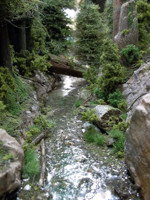

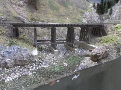

I also use Envirotex Lite. I use a small blow torch quickly over each thin pour to make the Envirotex a thinner consistency which lets any bubbles to rise, otherwise the Envirotex is too thick for the bubbles to come to the surface. Hit it a few more times with the torch to "pop" the surface bubbles. I rarely have bubble issues. In areas where it may creep up on a rock, log or bank just use a paint brush with a flat clear coat or glue a bit of dust, dirt or ground foam on the area. There is also a dye that can be added the the mix. The key is to pour thin layers, get the bubbles out and let it dry before pouring the next layer. I did a few mockups before I poured on the layout. These are some water scenes on the Sonoma Mountain Railroad.
