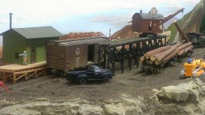

I used real dirt on my entire layout. I used dirt that was naturally dry. I found that clay clumps were the best because of the fine texture, however I used a variety of sieves to create both ballast and different dirt products. Simple kitchen colanders work fine.
Scenic Cement works very well to adhere the dry dirt. Also, the diluted elmers glue/water mixture works. First wet the area then apply dirt, then mist.
Check out the video of the completed layout to get an idea of the different effects that can be obtained:
[video=youtube;n0_XJIQDYVo]https://www.youtube.com/watch?v=n0_XJIQDYVo[/video]
hope this helps

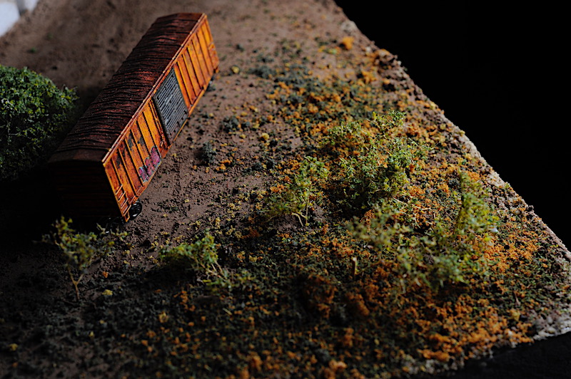

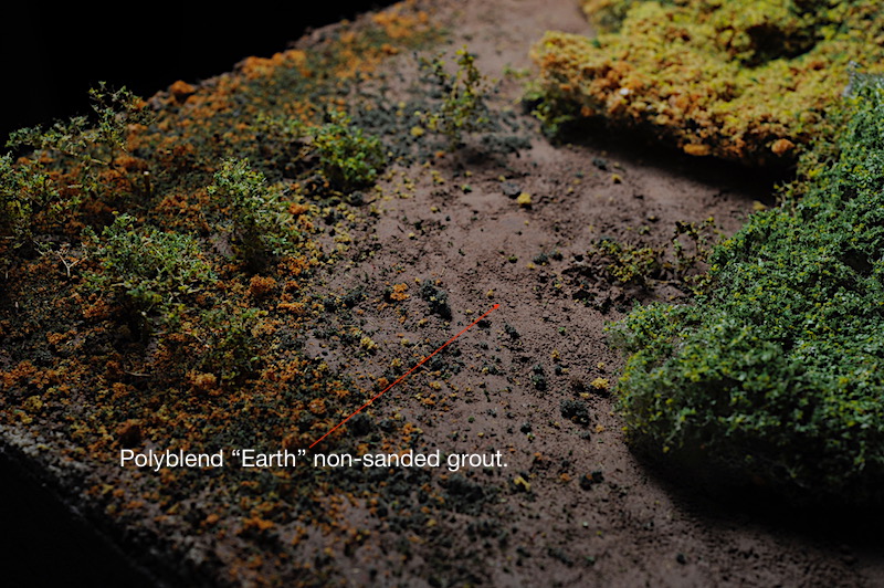

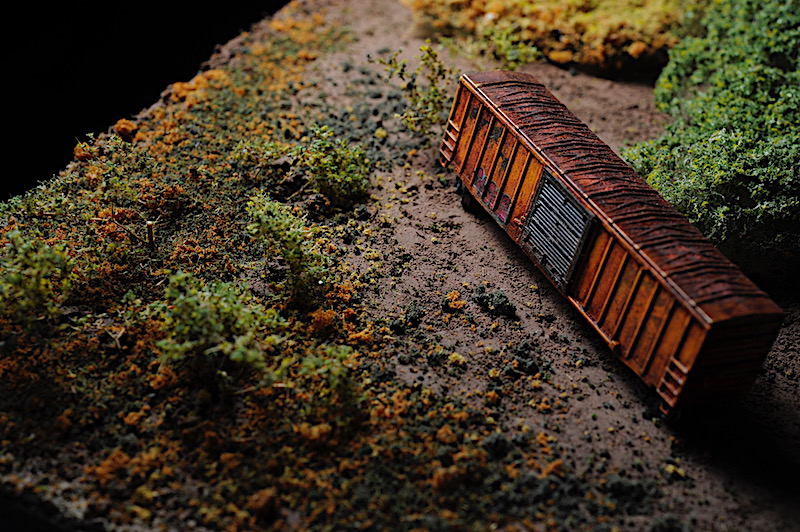

I model N-scale, so I need finer "dirt." I use non-sanded Polyblend grout from Home Depot. I use Polyblend's "Earth" for dirt, and Polyblend's "Haystack" for sand. Plus, they make a ton of other earth-tone, concrete- and asphalt-looking colors. Below is a test scene I did on the corner of my layout to try it out. My application process is super-simple:
• Sprinkle non-sanded grout in desired color onto layout.
• Smooth and flatten with an index card.
• Spray with scenic cement.
• Voila!
