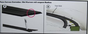

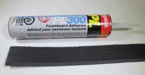

As a matter of fact, my WS 2x boxes of 24' continuous foam track bed arrived today. It also has a centerline that you can split and separate when applying around curves; one half foam bed at a time. This should help with the crunching up. I have not tried it yet.
It does look like a material that will easily compact if applied with a stapler, so I'll be using foam glue, when it comes the time.
What foam glue are you using and where did you get it? Thanks
I have not used anything, yet. When I do lay the bed down, I will be trying the LePage PL300 shown, that is sometimes on sale at the Home Depot.
I also include WS instructions for the curve diagram.
. FoamBed_03-10-2020 (1).JPGFoamBed_03-10-2020 (2).JPGFoamBed_03-10-2020 (3).JPG
I believe the caulk gun stuff might be the cheapest way to go. I'm hoping to glue everything with 1 tube.
